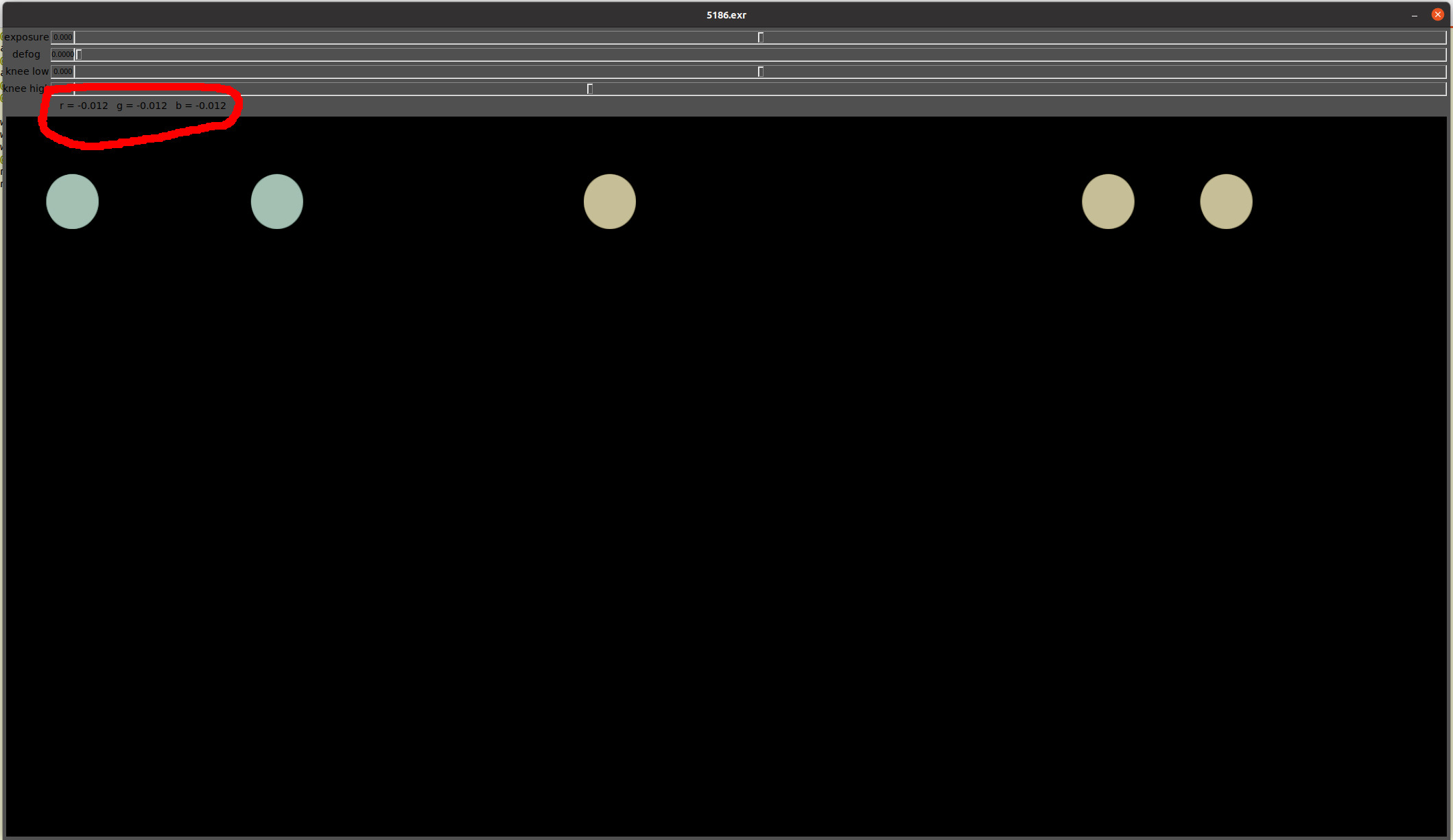

Re: problems with BACKGROUND
You original image doesn't have NaNs but have negative values:bartek_zgo wrote: Tue May 11, 2021 12:17 pm The interesting thing is that original file do NOT have any NaN.
It is still stuff a light source can not emit. Use exrtools (i.e. exrdisplay in this case) to check .exr files; it is the reference ILM OpenEXR implementation.
