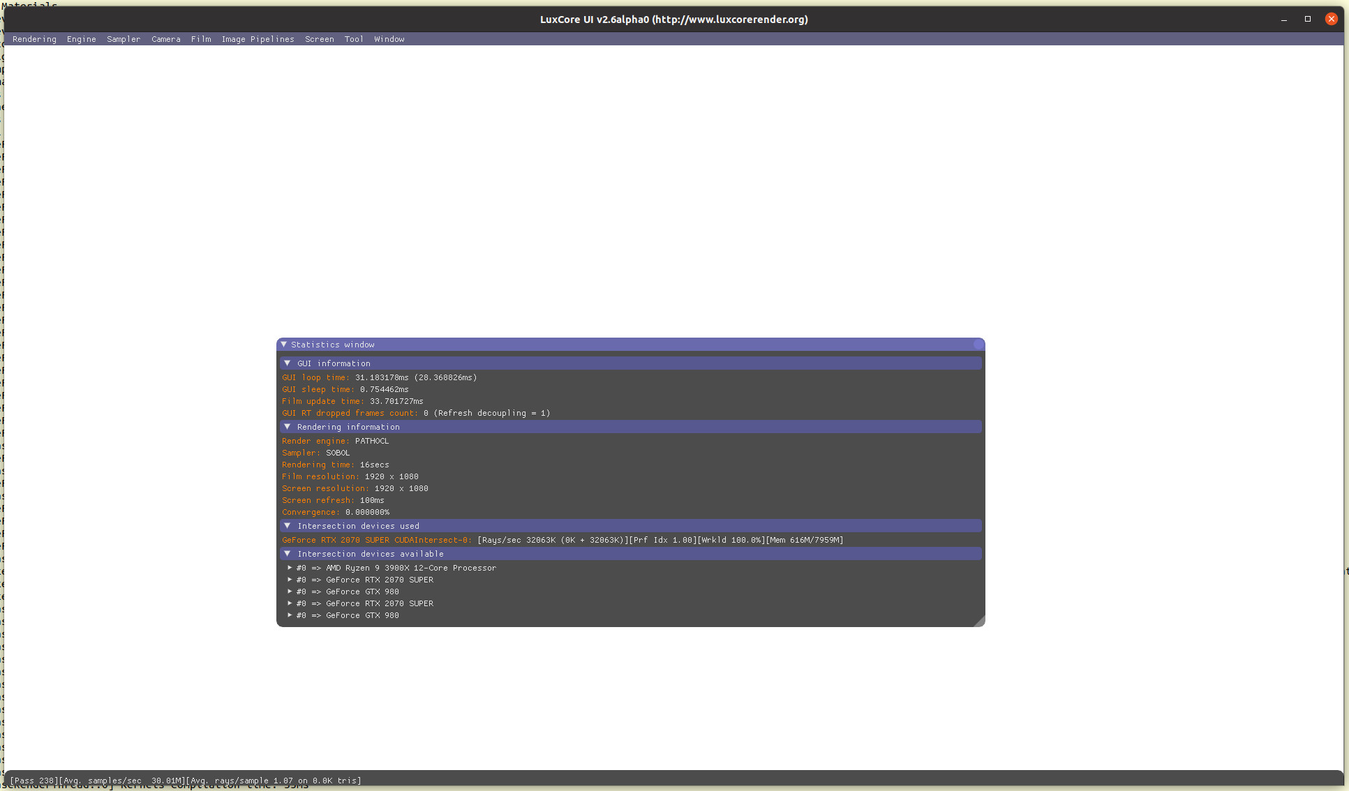

And here is a picture of a newly created .blend:
P.S.: the total amount of VRam (4Gb) in the second one is because I left enabled the GTX970, so the limit is 4Gb, but the result is the same with the RTX2080Ti alone
