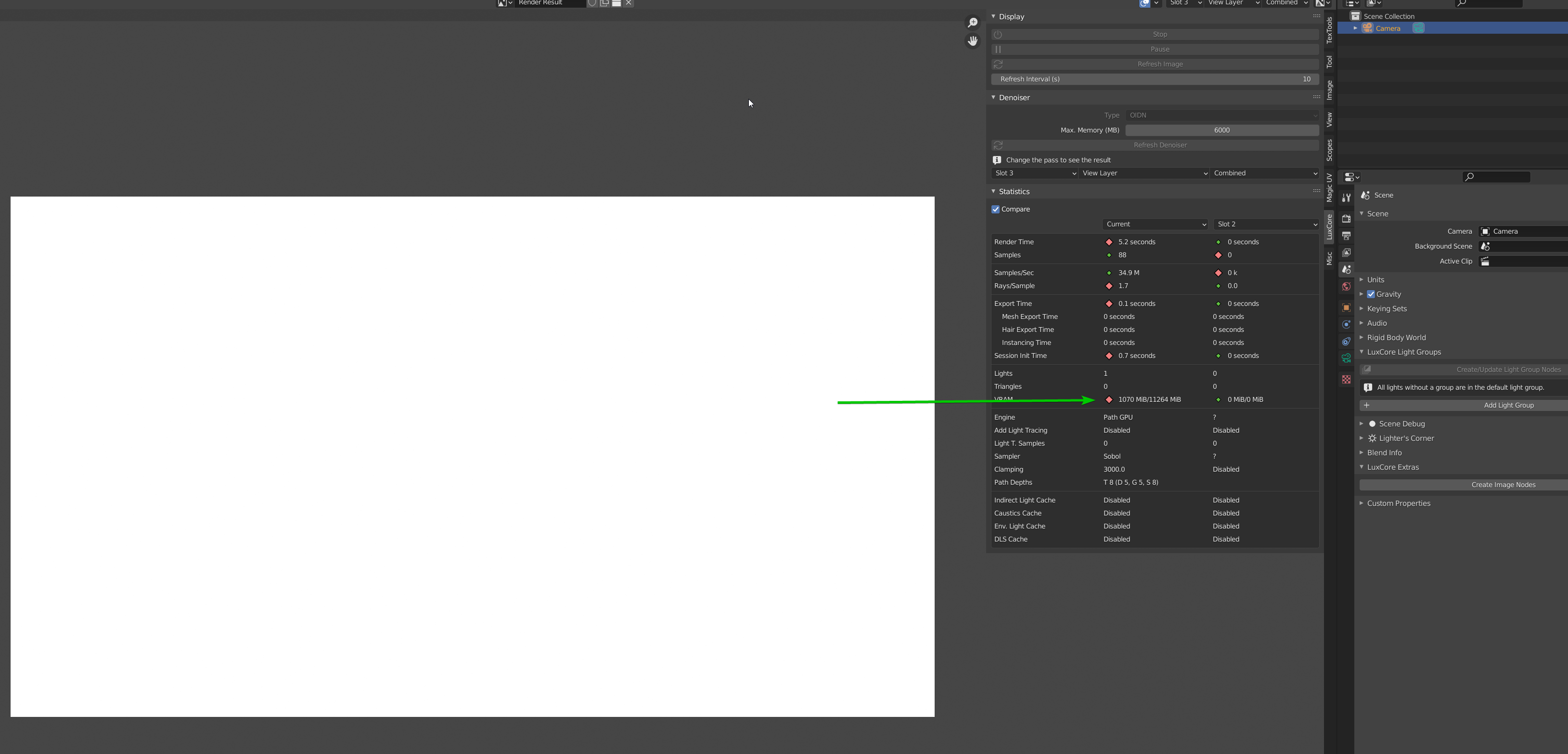

I was debugging one of our scenes (the exterior I showed before) and then I realized something weird was happening, after emptying and cleaning EVERYTHING in the scene, it takes 1.07Gb of Vram to render it.
A new scene takes 270Mb, but for some reason this scene takes 1.07Gb, no caches enabled, nothing weird that I can see there, so I don't understand what's happening, here is the file:
FULLY_EMPTY_1Gb_VRAM.zip
(178.68 KiB) Downloaded 822 times
There may be something weird in my computer, but a new blender scene takes just 270Mb, so there must be something going on there.
P.S.: Blender 2.92 - LuxCore 2.5 Release - RTX2080Ti

But I’m talking about VRAM during render, no file size, besides I deleted everything, in that version some como nodes were still there, but on discord I uploaded another version without those, still 1Gb of VRAM, something is happening there but I don’t know what :S

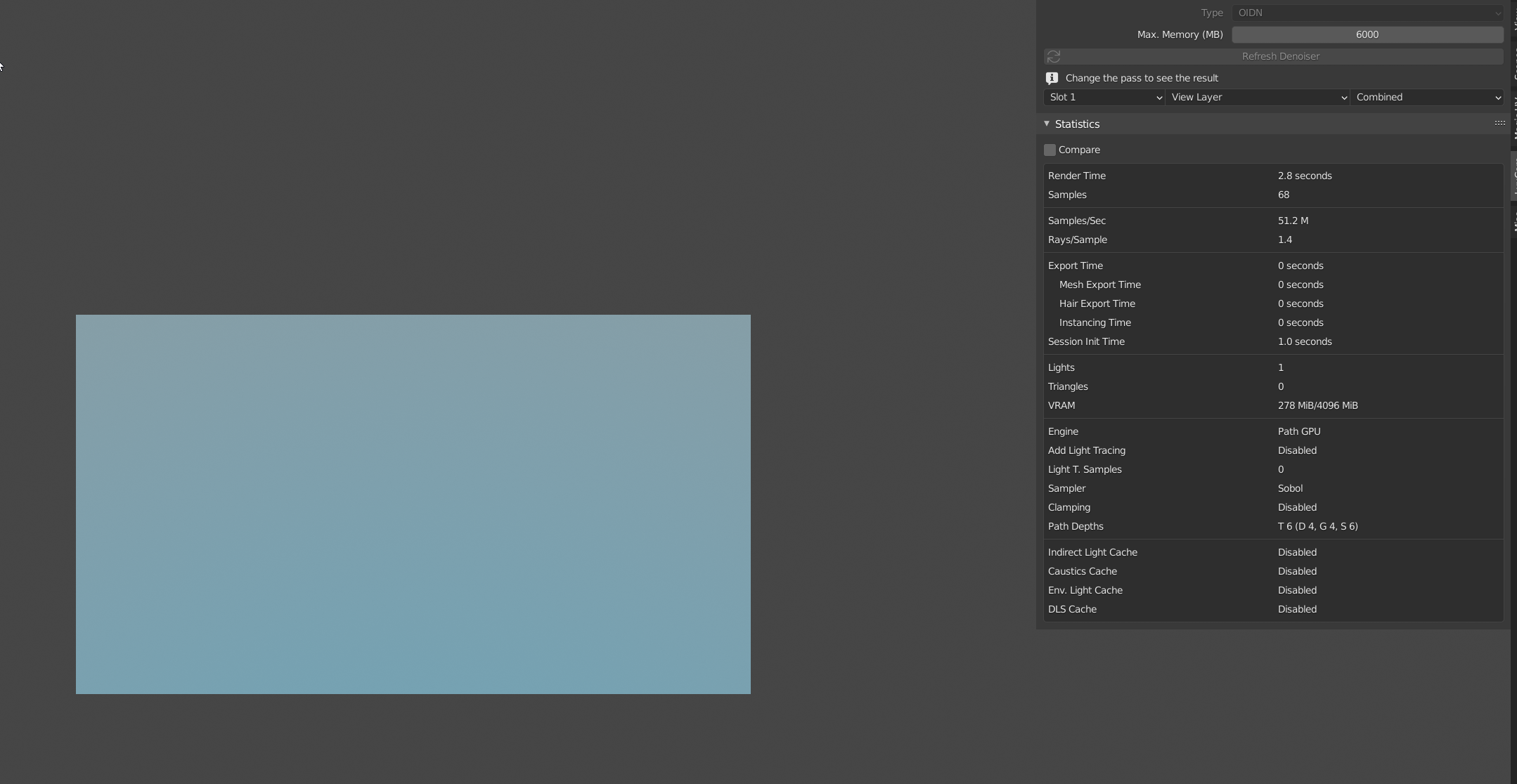

And here is a picture of a newly created .blend:
P.S.: the total amount of VRam (4Gb) in the second one is because I left enabled the GTX970, so the limit is 4Gb, but the result is the same with the RTX2080Ti alone
