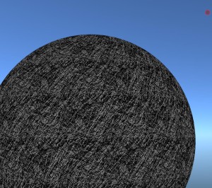

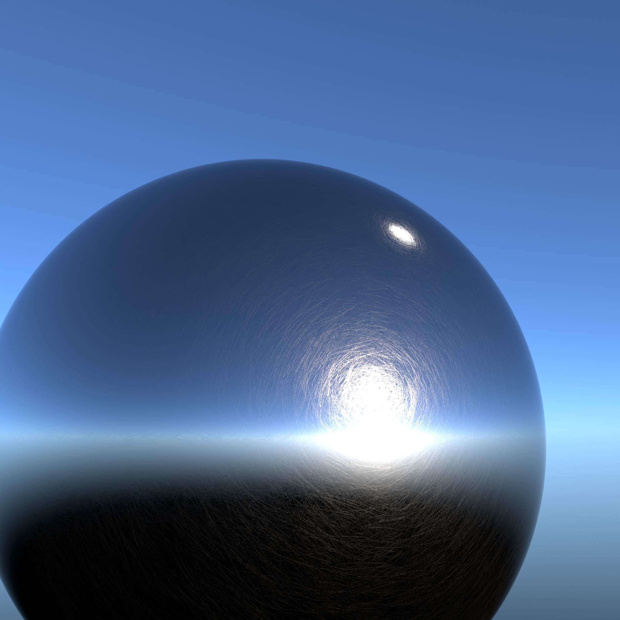

there is another example to explain the convenience of{anisotropic rotation} in dealing with certain situations:
A metal ball with many very slight scratches. When the ball reflects the highlight of the light source, the scratches around the highlight (although their directions are randomly distributed) are also partially illuminated, but always appear to be rotating around the highlight.
scratches in blender viewport:
Anisotropic rotation calculated by node in blender viewport:

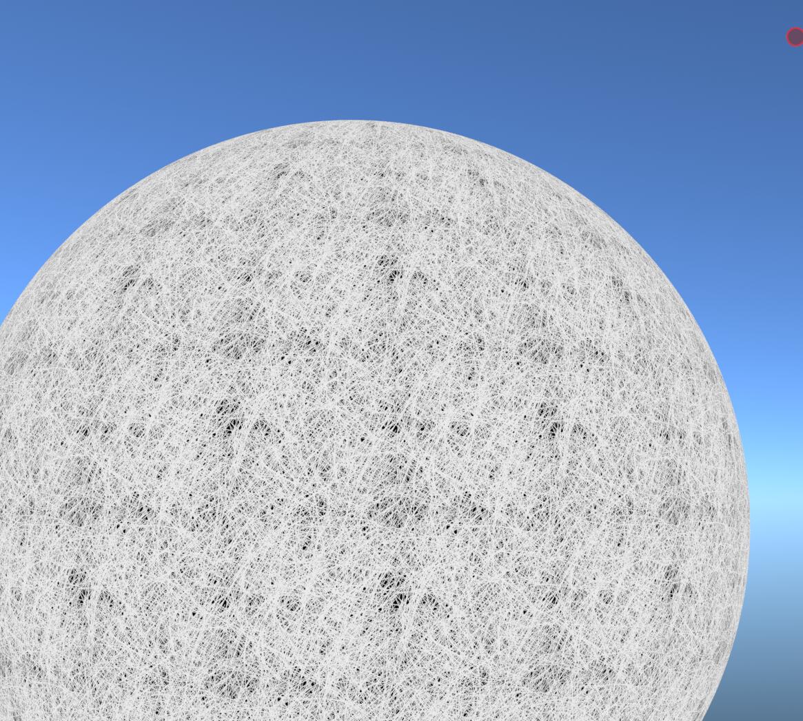

texture file:
the .blend file:
Messy scratches.blend
(1.83 MiB) Downloaded 3589 times

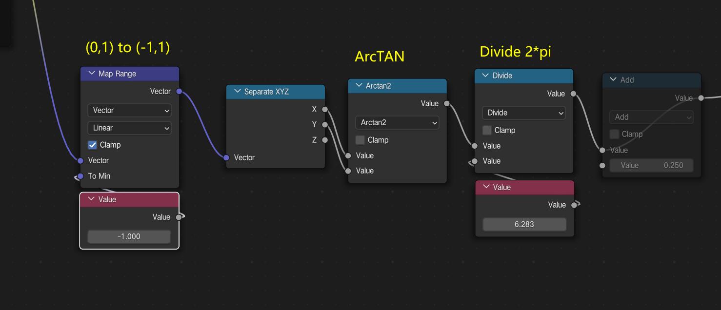

using [Vector Brush] or [Flow Map Painting] by Mari or Substance Painter, to get the RG two-color map with scratch direction information, and then get the anisotropic rotation map through node calculation:
(in some renderer may add 0.25 at the end)
