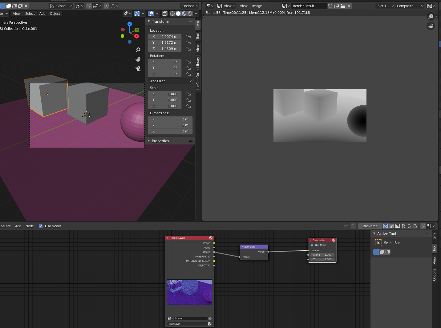

It is more than strange. I have created simple scene in blender. Open image with composer and made normalization:
Everything is OK. Than I export the scene with Luxcore FileSaver and render with standalone. Open with gimp:
As you can see in Blender the sky is white, in gimp black.

The value is set to infinity:
https://github.com/LuxCoreRender/LuxCor ... r.cpp#L426
However there are many conversions and factors from there that may affect your end result like FP 32 to 16, etc.
