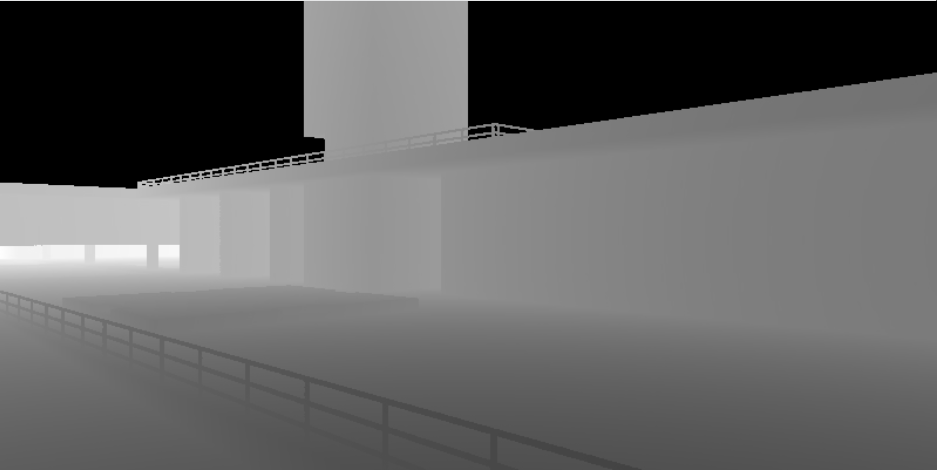

I think so too, but when I try to do that, I get a very flat result (see attached).

josephmcs wrote: Thu Feb 25, 2021 1:31 am I think so too, but when I try to do that, I get a very flat result (see attached).
The depth AOV is an HDR image, I have the feeling you assume the values are between 0.0 and 1.0 (while it is between 0.0 and +INF).

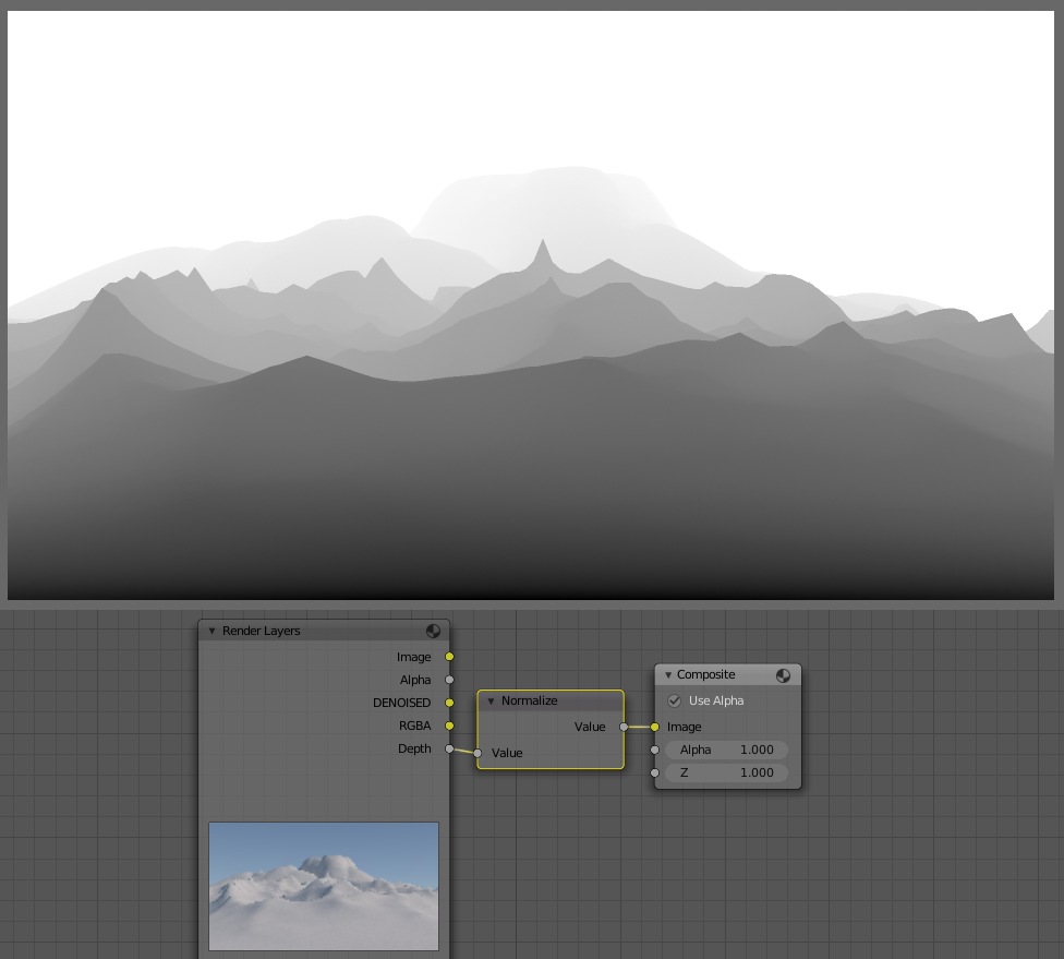

It is more than strange. I have created simple scene in blender. Open image with composer and made normalization:

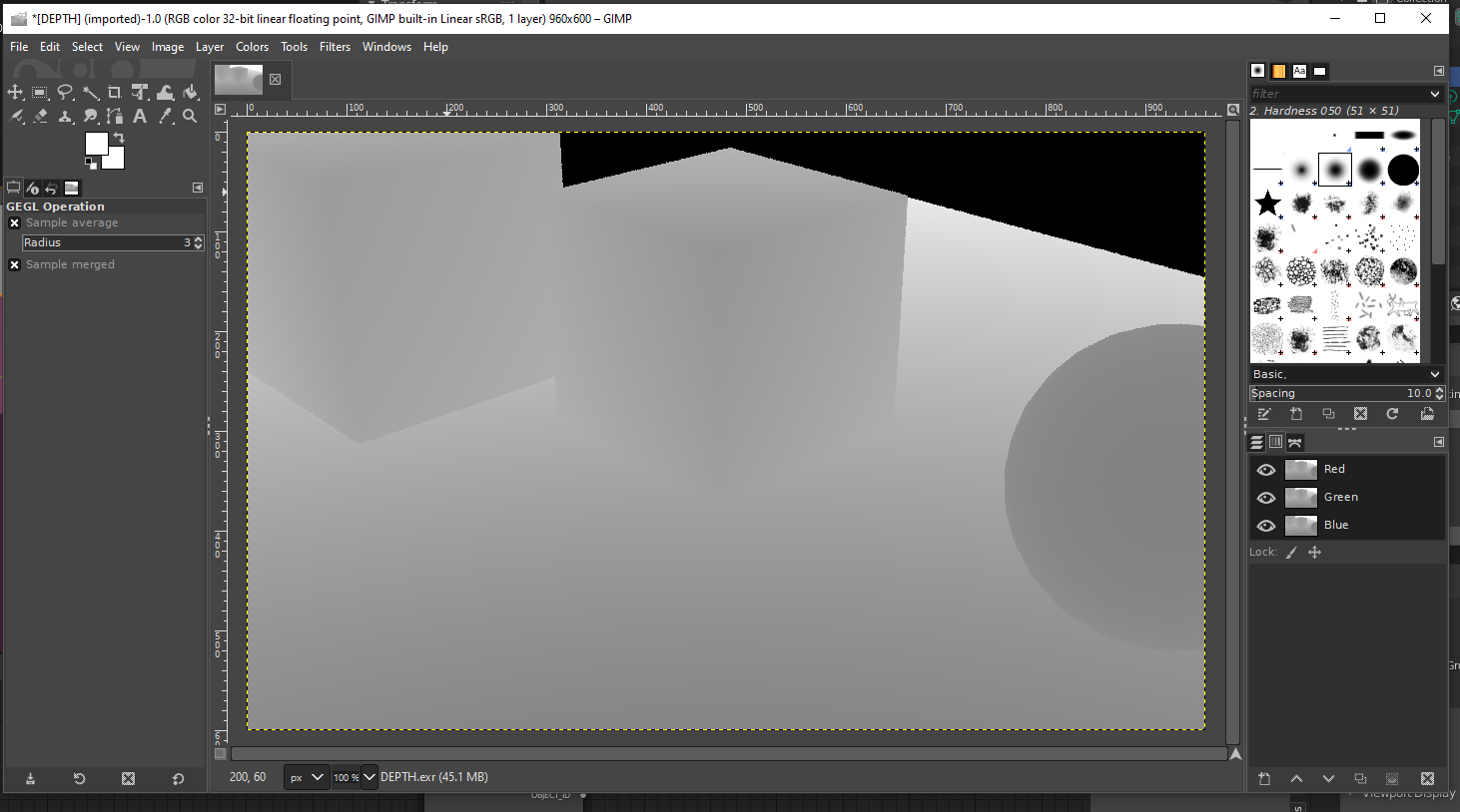

Everything is OK. Than I export the scene with Luxcore FileSaver and render with standalone. Open with gimp:
As you can see in Blender the sky is white, in gimp black.

The value is set to infinity: https://github.com/LuxCoreRender/LuxCor ... r.cpp#L426
However there are many conversions and factors from there that may affect your end result like FP 32 to 16, etc.
