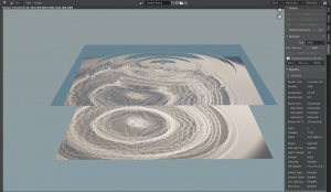

My scene have a water surface, and a simple plane beneath it. I want to render caustics, and I want to see the caustics effect through the water, but it´s not working. It seems that water object is blocking the view.
I,m using Lux 2.4 on Blender 2.83.12.

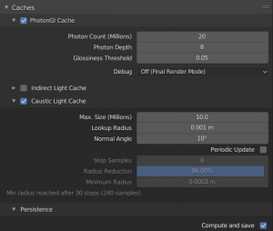

:idea: You can enable the Caustics Light PhotonGI Cache to see caustics through reflections and refractions (Specular-Diffuse-Specular paths).
You can tweak the parameters depending on what kind of clarity you want. The default settings were a little blurry, so with some small adjustments, I got a fairly clear result:
Caustics Cache settings
Result
Result
P.S. I think you forgot to enable Shade Smooth on your water mesh :?: For the render result shown above, I have enabled Shade Smooth.

That is also true of LuxCore. The box at the bottom under Persistence (Compute and save) does that. Check that box. Once you have your parameters how you like it, un-check it. The next time it will be faster to start because it can load the pre-computed cache data from the file.
And yes, if your lights and objects do not change or move during the animation, you can re-use it for each frame, too, even if the camera moves. However if the objects are animated, you should not re-use the cache for different frames.

Leandro Oliveira wrote: Fri Feb 12, 2021 12:19 am I started a new file and I did the same setup, but this time, it´s not working...
From what I can tell, viewport renders do not use photons from the PhotonGI cache. To see them, you need to press F12 and do a full render.
Click under Persistence the checkbox Compute and save and choose a file path next to your .blend file. Then press F12 to start a render. You don't need to finish the render, you can stop it as soon as you see pixels appearing. Then you can uncheck the box and your future renders will read photons from that file. (Only full renders, still not viewport renders, sorry)
