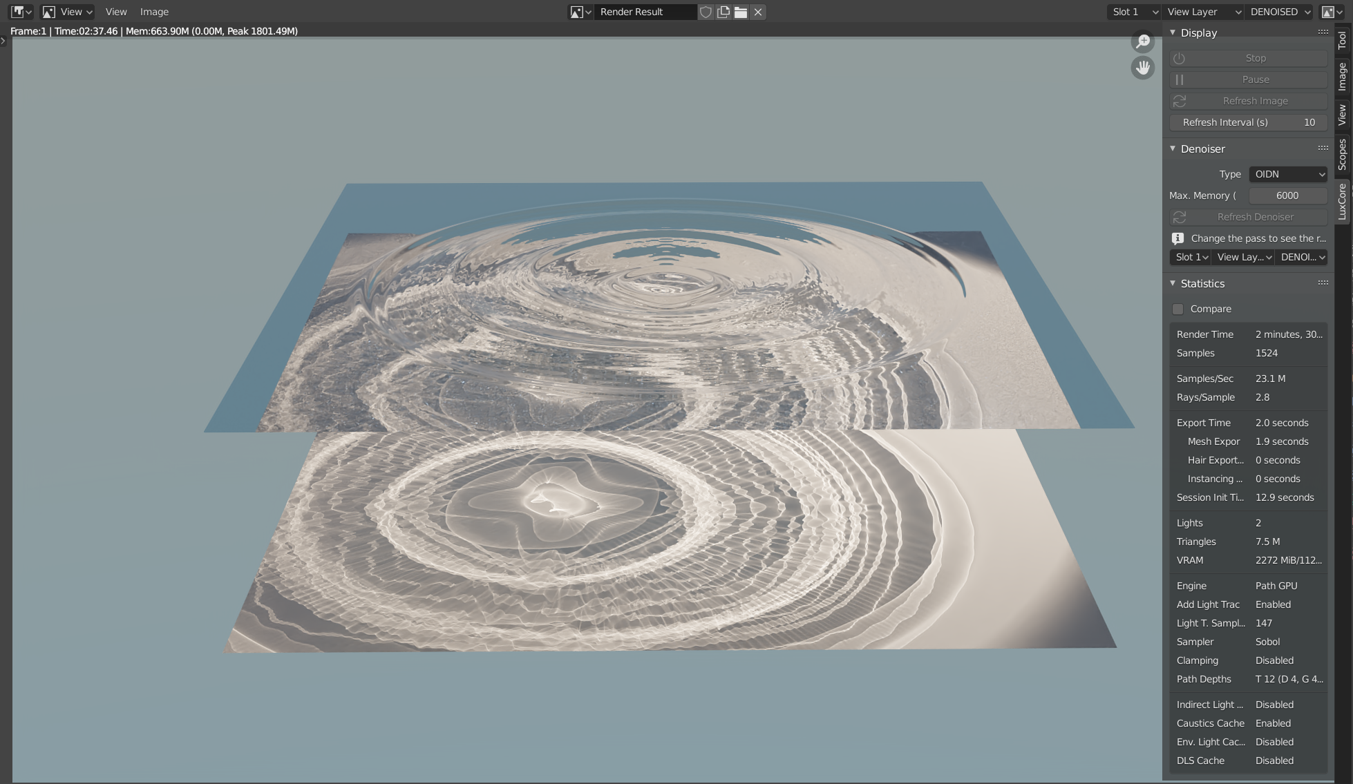

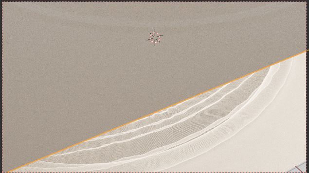

My scene have a water surface, and a simple plane beneath it. I want to render caustics, and I want to see the caustics effect through the water, but it´s not working. It seems that water object is blocking the view.
I,m using Lux 2.4 on Blender 2.83.12.

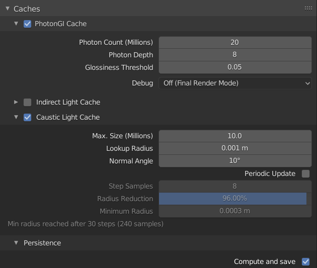

:idea: You can enable the Caustics Light PhotonGI Cache to see caustics through reflections and refractions (Specular-Diffuse-Specular paths).
You can tweak the parameters depending on what kind of clarity you want. The default settings were a little blurry, so with some small adjustments, I got a fairly clear result:
Caustics Cache settings
Result
Result
P.S. I think you forgot to enable Shade Smooth on your water mesh :?: For the render result shown above, I have enabled Shade Smooth.

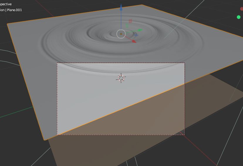

Martini, sorry for bother you with this subject, but could you take a look in the attached file? I started a new file and I did the same setup, but this time, it´s not working...
test water 4 .blend
(1.05 MiB) Downloaded 1356 times

Leandro Oliveira wrote: Fri Feb 12, 2021 12:19 am I started a new file and I did the same setup, but this time, it´s not working...
From what I can tell, viewport renders do not use photons from the PhotonGI cache. To see them, you need to press F12 and do a full render.
Click under Persistence the checkbox Compute and save and choose a file path next to your .blend file. Then press F12 to start a render. You don't need to finish the render, you can stop it as soon as you see pixels appearing. Then you can uncheck the box and your future renders will read photons from that file. (Only full renders, still not viewport renders, sorry)
