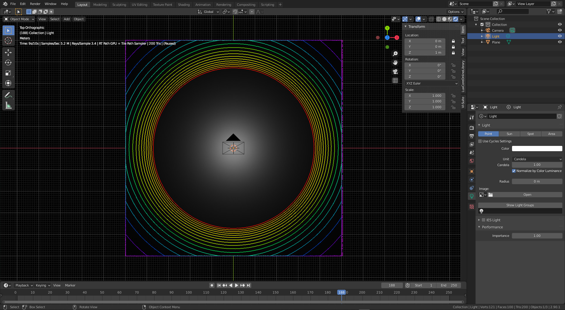

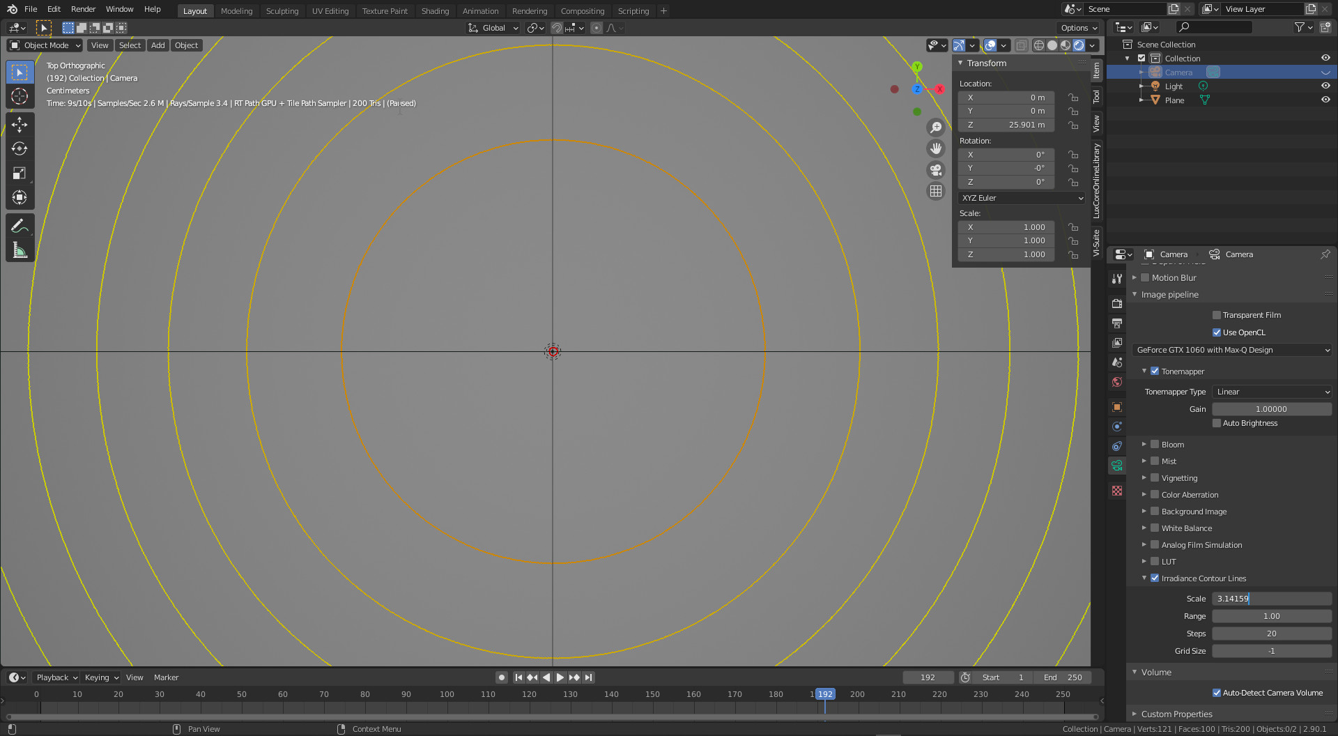

I'm trying to check the Irradiance Contour Lines will make on the XY plane (10mx10m) when illuminated by a 1 Candela Point Light source at 1 meter distance and perpendicular to center of the plane.
My understanding or assumptions are as follows:
* Luxcore Luminous Efficiency is 179 lm/W
* The Lux value of the illuminated XY plane at center and at the zenith from the Point Light source of 1 candela (1 lumen/steradian) and at 1 meter distance or radius is calculated to be 1 lux (1 lumen/sq. meter).

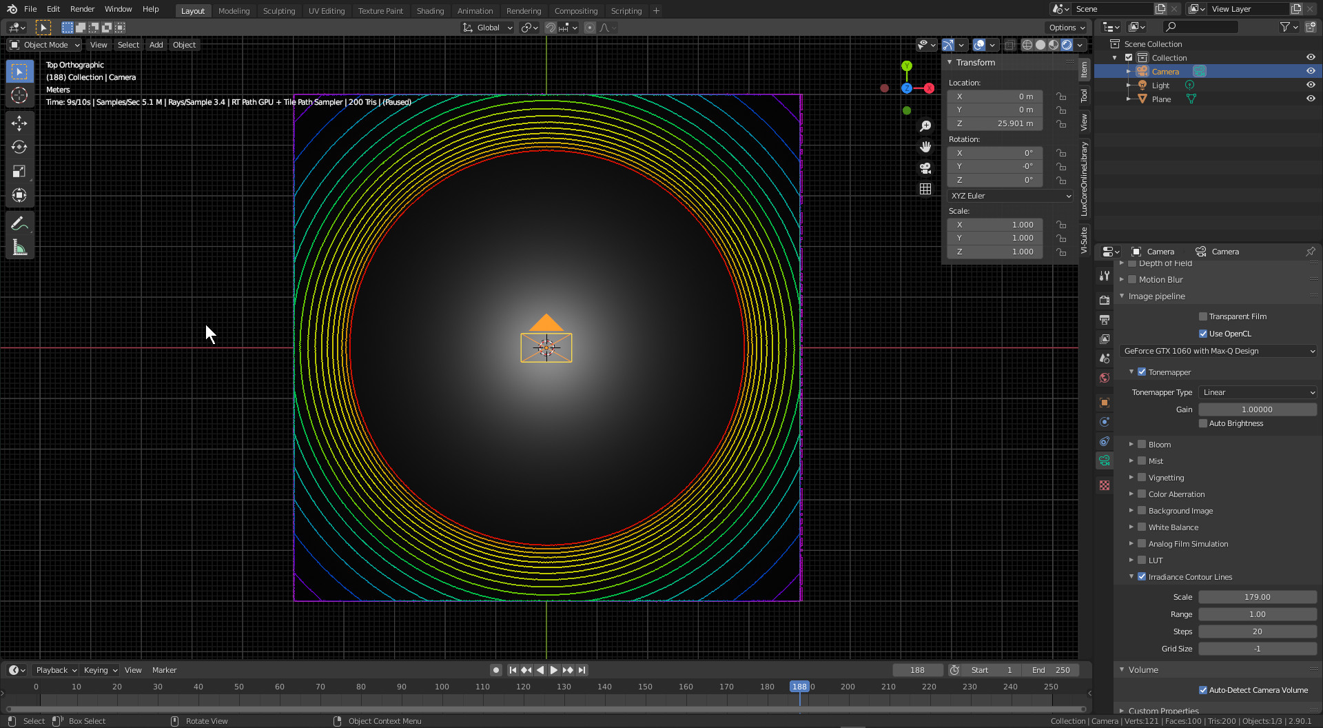

Under Irradiance Contour Lines settings are the following:
*Scale: ????
*Range: 1 assuming the lux range on the illuminated XY plane is to be from maximum of 1 lux (inside the red contour) at its center to minimum 0 lux (outside the purple contour region) at infinite edge of the XY plane
*Steps: 20
I tried to use the default Scale of 179 but I cannot get the red contour line nearest the center of the plane even with Steps set at 20.
Are there something wrong with the above assumptions? What is the correct Scale setting and what value to set there to correspond to the actual lux values in the illuminated XY plane?
Thanks
Jan
Posts: 37
Re: Irradiance Contour Lines Calibration Problem
Post by Jan »

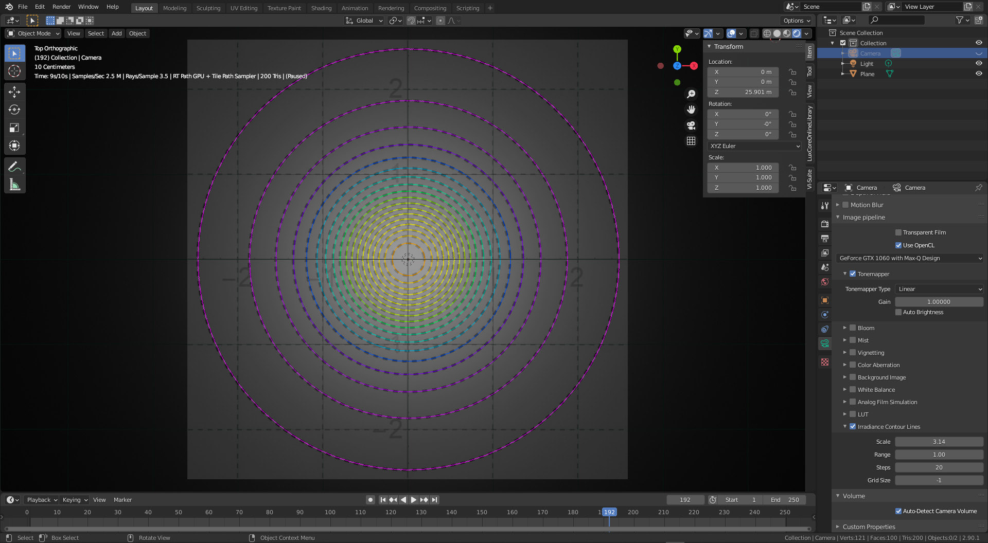

This is what I have found.

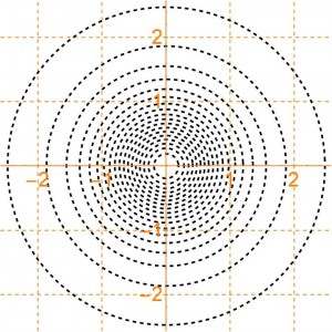

For the red and innermost contour to be exactly at the center and which correspond to 1 lux the Scale has to be set at 3.14159 or exactly the value of PI.

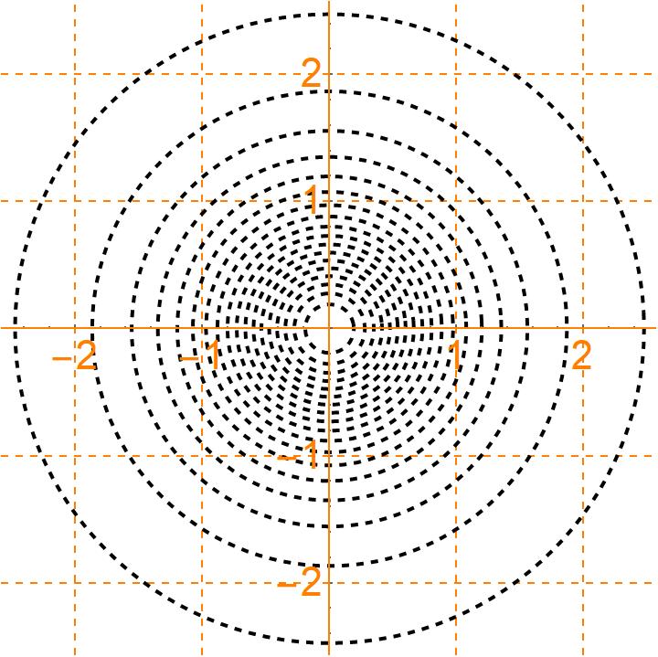

This is the math function:
z*Tan[ArcCos[lux^(1/3) z^(2/3) where lux = lux + 1/19 until lux = 1; z = 1 the distance from point source and perpendicular to the center of the plane.
These are the contour radii in measurements using the above math function:
{ComplexInfinity, 2.47394, 1.86696, 1.55664, 1.35119, 1.19797, \
1.07537, 0.972535, 0.883228, 0.803531, 0.730778, 0.66302, 0.598719, \
0.536539, 0.475177, 0.413145, 0.348407, 0.277433, 0.191578, 0.}

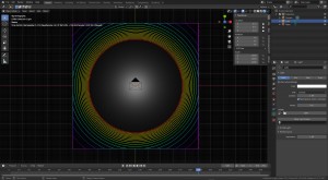

Plotted and then overlay and compared to LuxRender Irradiance Contour
radiosity5.blend
(830.7 KiB) Downloaded 542 times
Is this correct? Why scaled to 3.14159..... or Pi? :o
