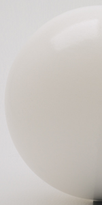

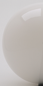

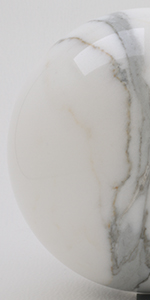

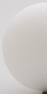

Hi, i want to share here a problem which is common to many rendering engines. I found the same problem in Maxwell Render, indigo render, Cycles and now Luxcore. The problem shows up mainly in bright materials which need two overlapping reflection types: diffuse light reflection and specular light reflection. The problem in all rendering engines we tried is that the diffuse reflection do not fades correctly at the tangent as soon as the specular reflection starts to dominate the scene, causing an excess of reflection. They sum instead of replacing each other.
In order to demonstrate the problem we produced something like an real Cornell box in which we put real material samples and take photos of them with a Sony R7SIII with a 50mm Zeiss lens. Conversion from RAW to JPG has been done using RawTherapee by disabling every kind of correction and highlight suppression.
ceramic white.jpg (26.96 KiB) Viewed 48285 times
barble white.jpg (33.18 KiB) Viewed 48285 times
paint white semiglossy.jpg (25.4 KiB) Viewed 48285 times
this is a painted steel sphere so no SSS is happening.
white matte.jpg (26.61 KiB) Viewed 48285 times
