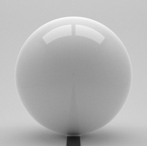

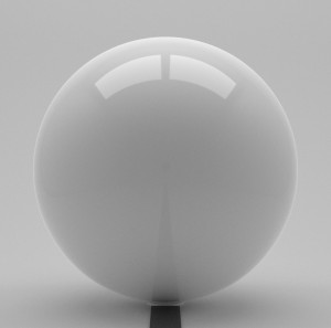

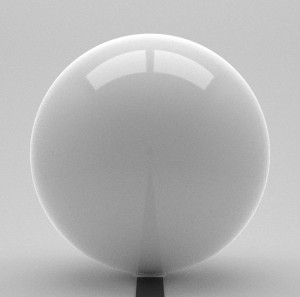

Hi, i want to share here a problem which is common to many rendering engines. I found the same problem in Maxwell Render, indigo render, Cycles and now Luxcore. The problem shows up mainly in bright materials which need two overlapping reflection types: diffuse light reflection and specular light reflection. The problem in all rendering engines we tried is that the diffuse reflection do not fades correctly at the tangent as soon as the specular reflection starts to dominate the scene, causing an excess of reflection. They sum instead of replacing each other.
In order to demonstrate the problem we produced something like an real Cornell box in which we put real material samples and take photos of them with a Sony R7SIII with a 50mm Zeiss lens. Conversion from RAW to JPG has been done using RawTherapee by disabling every kind of correction and highlight suppression.
ceramic white.jpg (26.96 KiB) Viewed 48102 times
barble white.jpg (33.18 KiB) Viewed 48102 times
paint white semiglossy.jpg (25.4 KiB) Viewed 48102 times
this is a painted steel sphere so no SSS is happening.
white matte.jpg (26.61 KiB) Viewed 48102 times

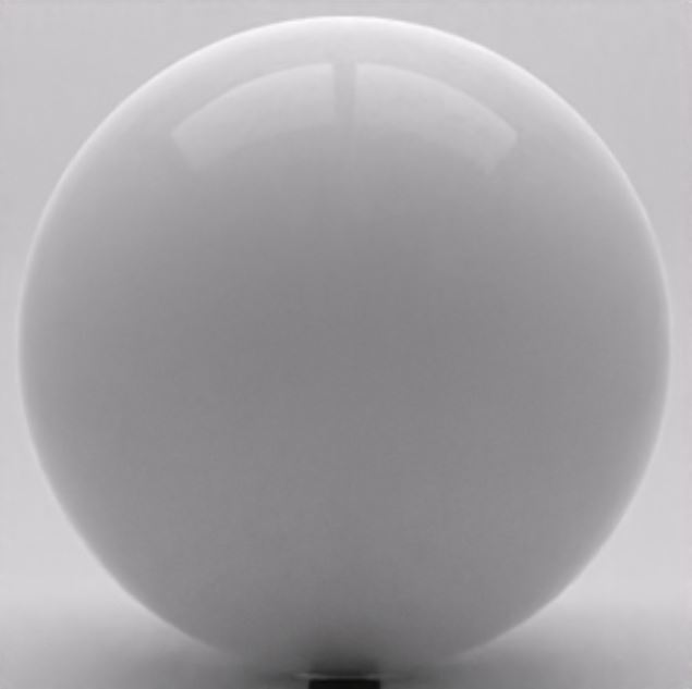

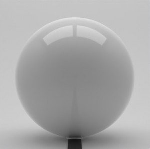

Instead this, or something very similar, is what we get with LuxCore and Maxwell.
Material is disney 70% white.
We are not able to get rid off the white halo, no way.

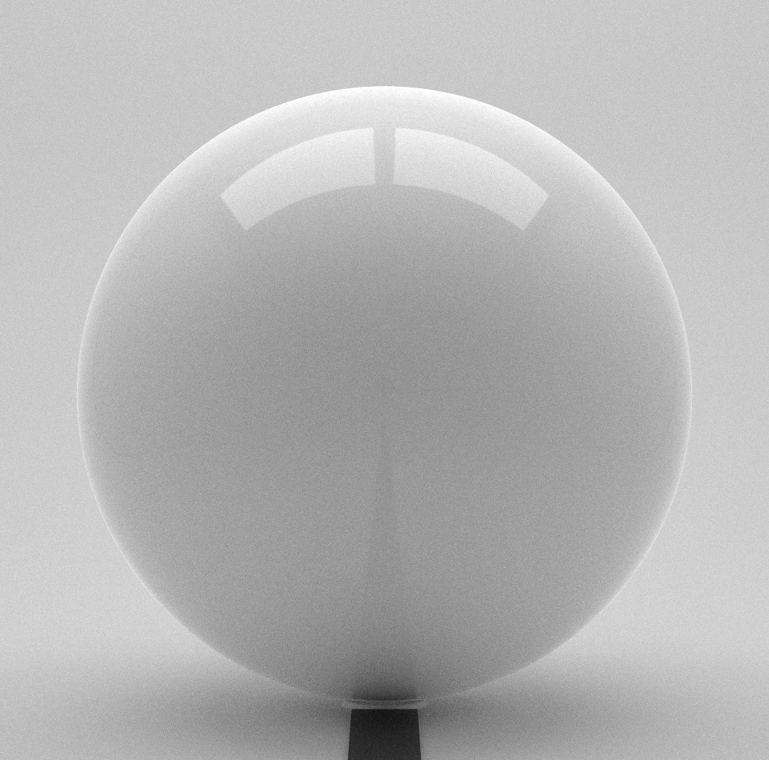

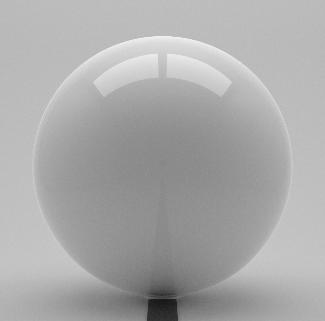

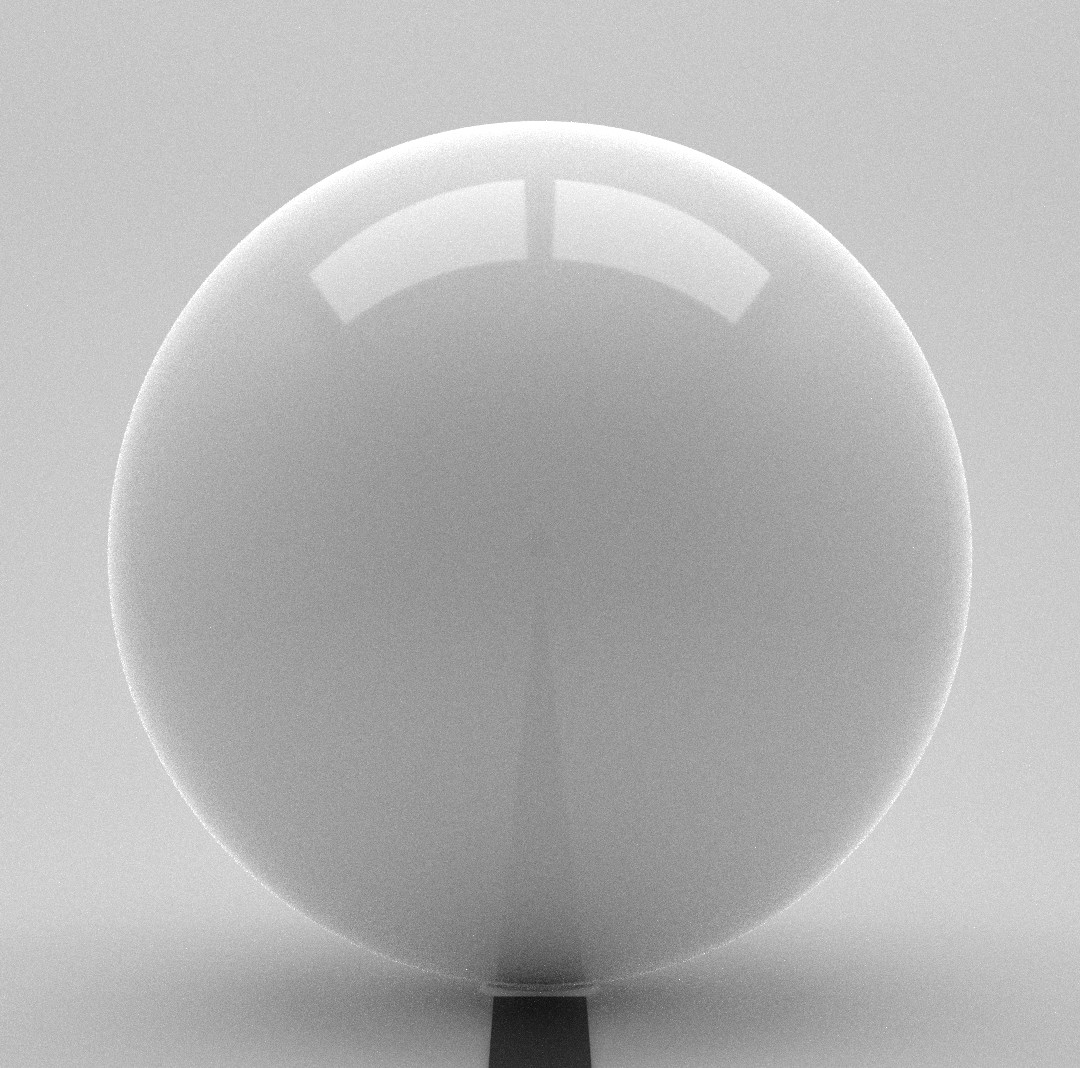

Same result here with Luxcore Vs Maxwell. No way to escape the bright rim around the ball.
Cycles Disney
Luxcore using Cycles Disney node
Luxcore Glossy2 node

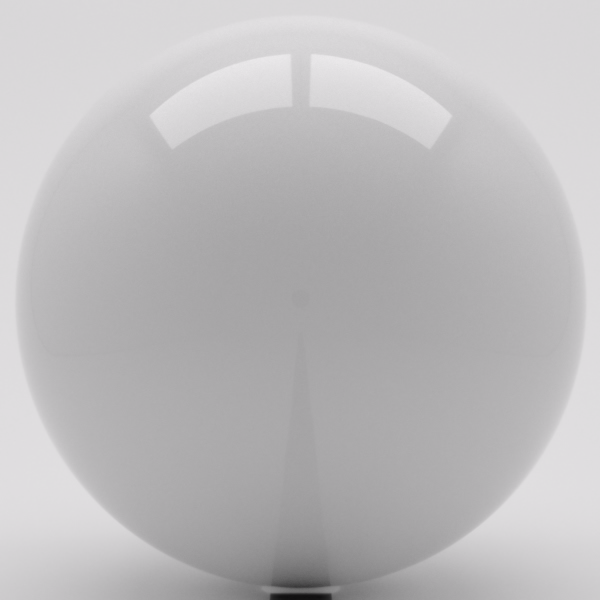

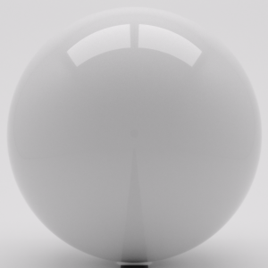

The only way i found to get something similar to the correct result by using Maxwell is by creating two spheres with a 0.2mm offset between them; to the outer sphere i applied a transparent plastic and to the inner one a white matte.
In Luxcore it should work in the same way.
It would be cool the archive this result directly from the shader.

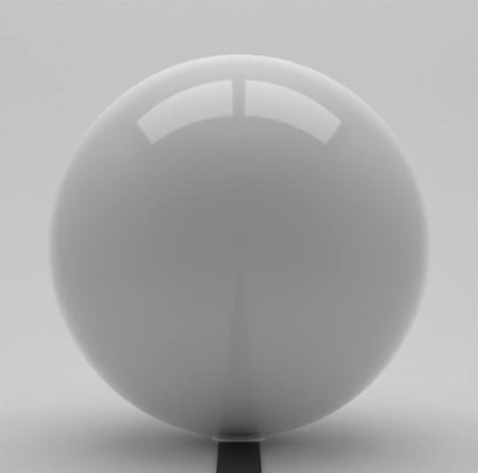

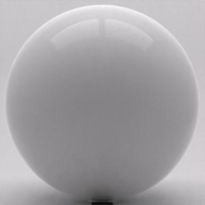

I had been trying something simillar with Luxcore absorption feature but it darken the shader.So i wasn't sure about the approach viability :
Luxcore Glossy2 absp 0.06
Luxcore Glossy2 absp 0.02
As you can see lowering the absorption deph make the bright rim even brighter.
