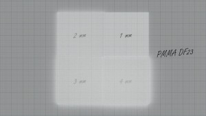

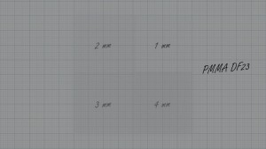

I did a comparision of two almost equal setups.
Both are using the same scattering volume definition but one with a perfectly polished surface and the other one with a surface using a little roughness (0,00001).
The results look like this:
polished surface
polished surface
little rough surface
Why does it appears that much different?

You are using a max. eye path depth of 100 and a max. light depth of 100. So a single sample can potentially require to trace O(100^2) rays with BiDir. Russian roulette save the day making possible to render this image at the cost of an insane variance. Using a roughness of only 0.00001 increase the variance even more.
Short version: they are fireflies.
Try to use normal path length and the result (like 10+10 max. path depth) will look more reasonable:

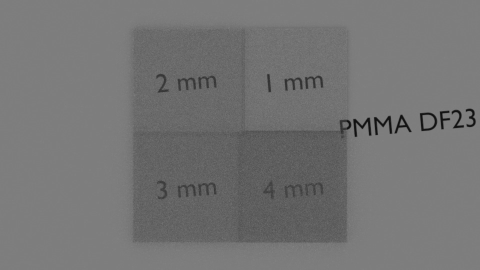

I've continued the investigation of the scatter volume and all the tests I've done share also one irregularity. The render results doesn't look blurry. It always appears like there's a colour fade out only with the growth in material thickness:
This is a photo of the material that is like imitate:
You see the written information blurr out with more material.
What do you think about that?

lighting_freak wrote: Mon Nov 23, 2020 3:46 pm I've continued the investigation of the scatter volume and all the tests I've done share also one irregularity. The render results doesn't look blurry. It always appears like there's a colour fade out only with the growth in material thickness:
That is not a property of the scattering volume, but of the surface!
You can see in the picture, and also the manufacturer says on the website, that it has a "satinated" surface.
So you need to model that. I think a normal map could be sufficient, and certainly more efficient than to model out the geometry.

CodeHD wrote: Mon Nov 23, 2020 4:20 pm That is not a property of the scattering volume, but of the surface!
On this pictures you may see that the sample plate is almost specular:
Anyway I ran tests with different surface settings (rough, matte translucent, bump) and none really turns out to reach blurry appearance. In most cases the darkening comes back.
daros wrote: Mon Nov 23, 2020 5:53 pm i think that the blurriness increases not because the mayor thickness but simply because the mayor distance between the upper surface and the paper behind
The sample has a plane rear surface and the distance of the surfaces to each other is simply given by the geometry of the plate.
