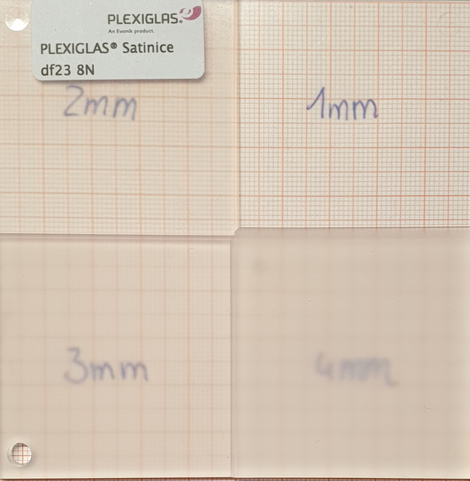

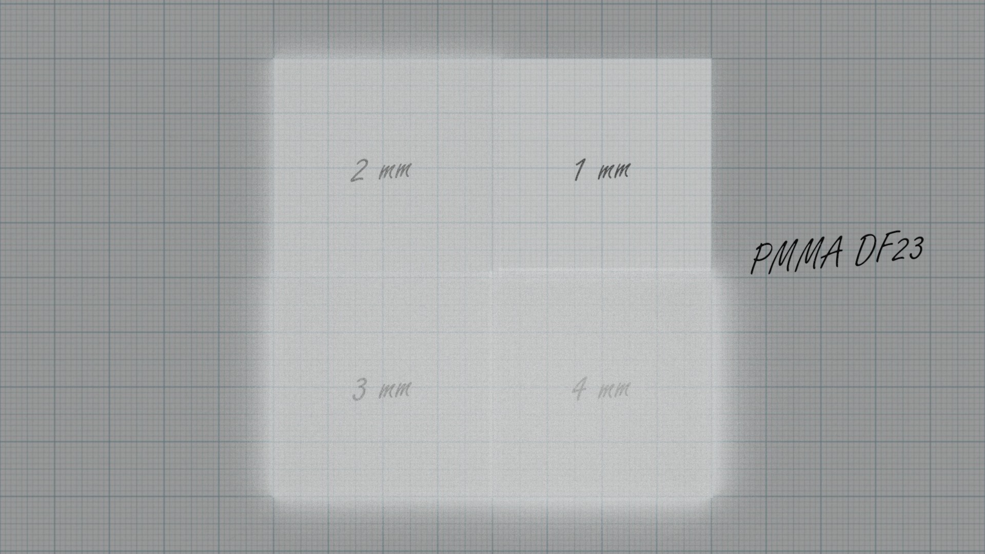

I've continued the investigation of the scatter volume and all the tests I've done share also one irregularity. The render results doesn't look blurry. It always appears like there's a colour fade out only with the growth in material thickness:
This is a photo of the material that is like imitate:
You see the written information blurr out with more material.
What do you think about that?

lighting_freak wrote: Mon Nov 23, 2020 3:46 pm I've continued the investigation of the scatter volume and all the tests I've done share also one irregularity. The render results doesn't look blurry. It always appears like there's a colour fade out only with the growth in material thickness:
That is not a property of the scattering volume, but of the surface!
You can see in the picture, and also the manufacturer says on the website, that it has a "satinated" surface.
So you need to model that. I think a normal map could be sufficient, and certainly more efficient than to model out the geometry.

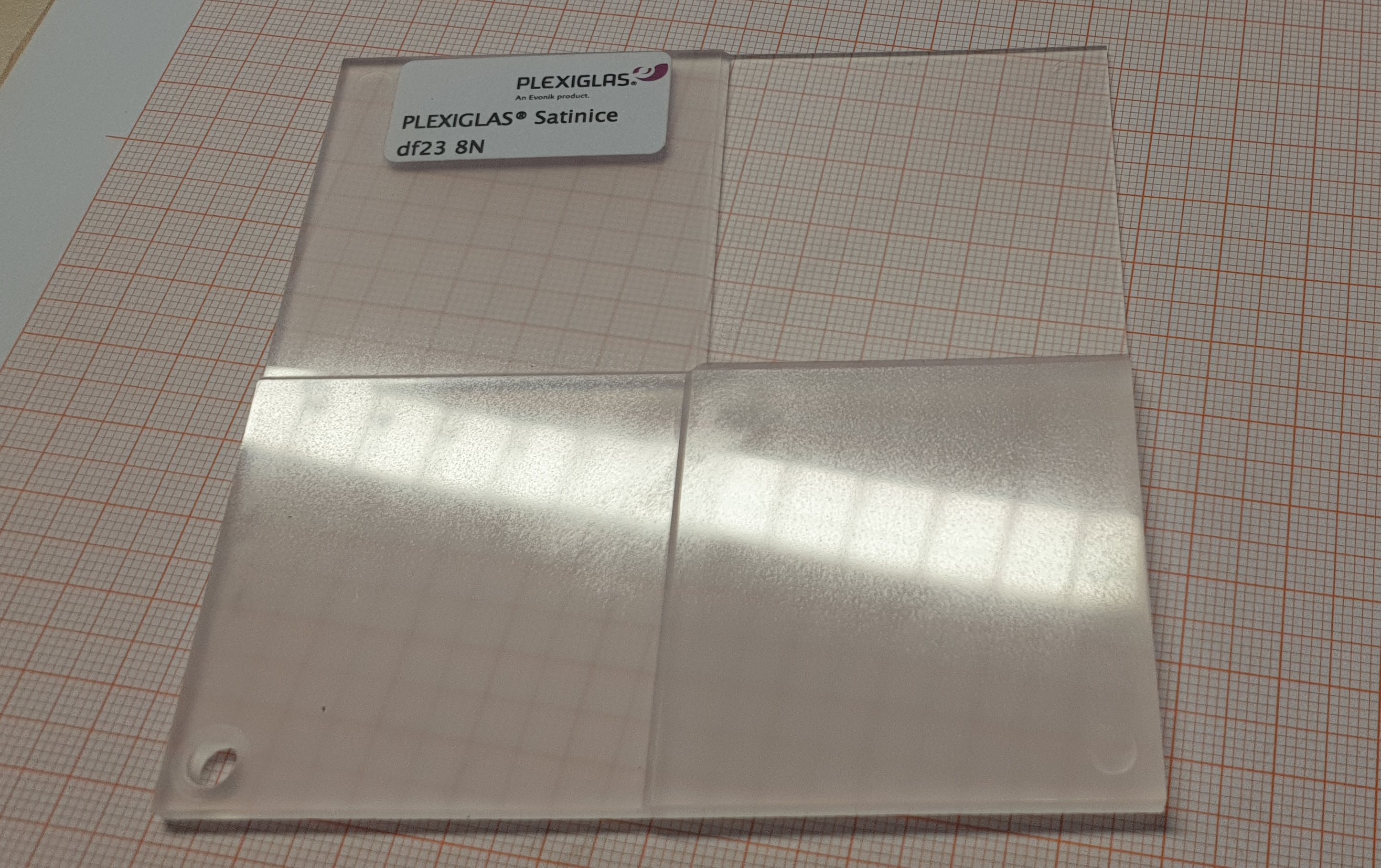

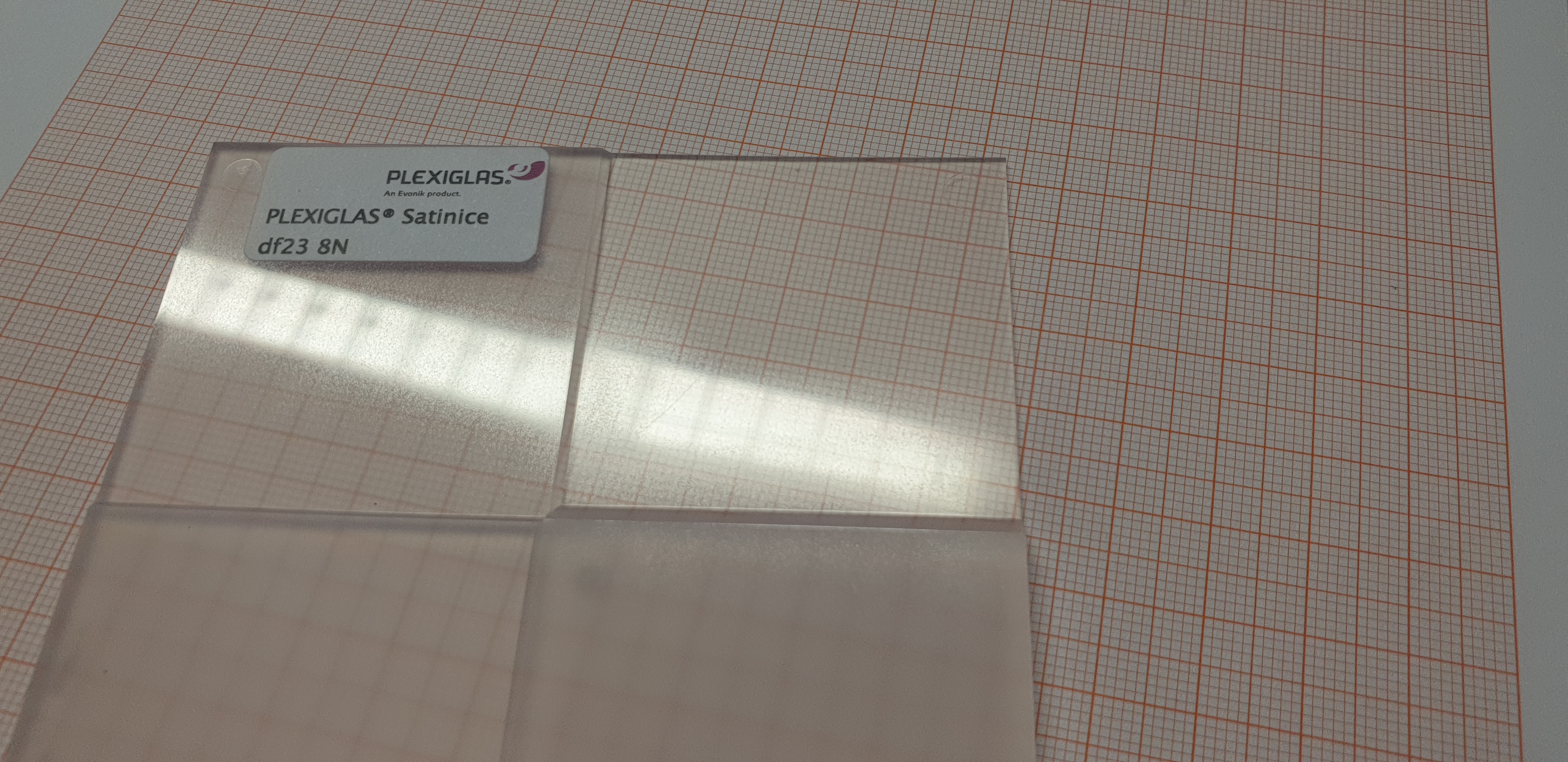

On this pictures you may see that the sample plate is almost specular:

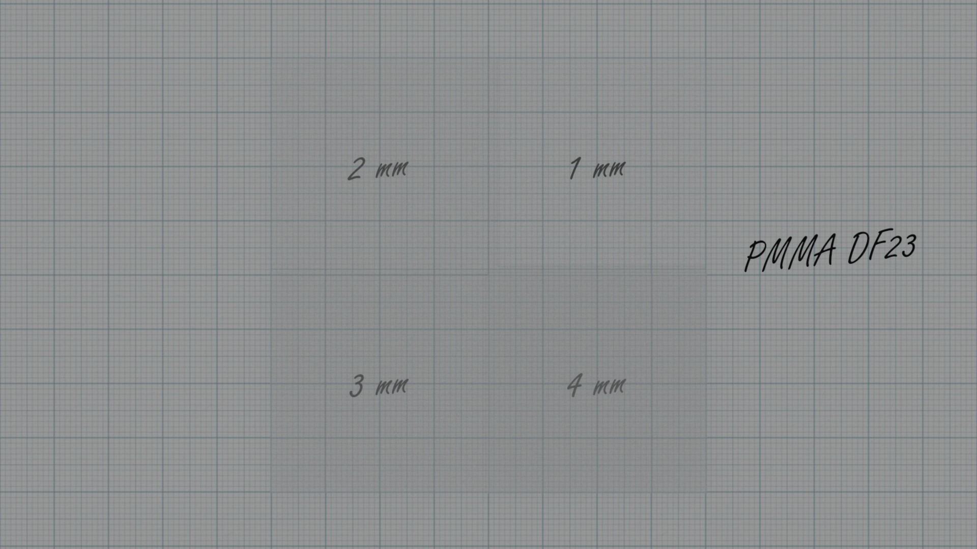

Anyway I ran tests with different surface settings (rough, matte translucent, bump) and none really turns out to reach blurry appearance. In most cases the darkening comes back.
