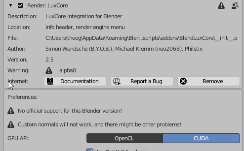

Did you use the daily built?
Did you read what it says?
See the sentence starting with "Custom Normals will not work ...."

These screenshots were taken in Luxcore 2.4 and Blender 2.83.7
