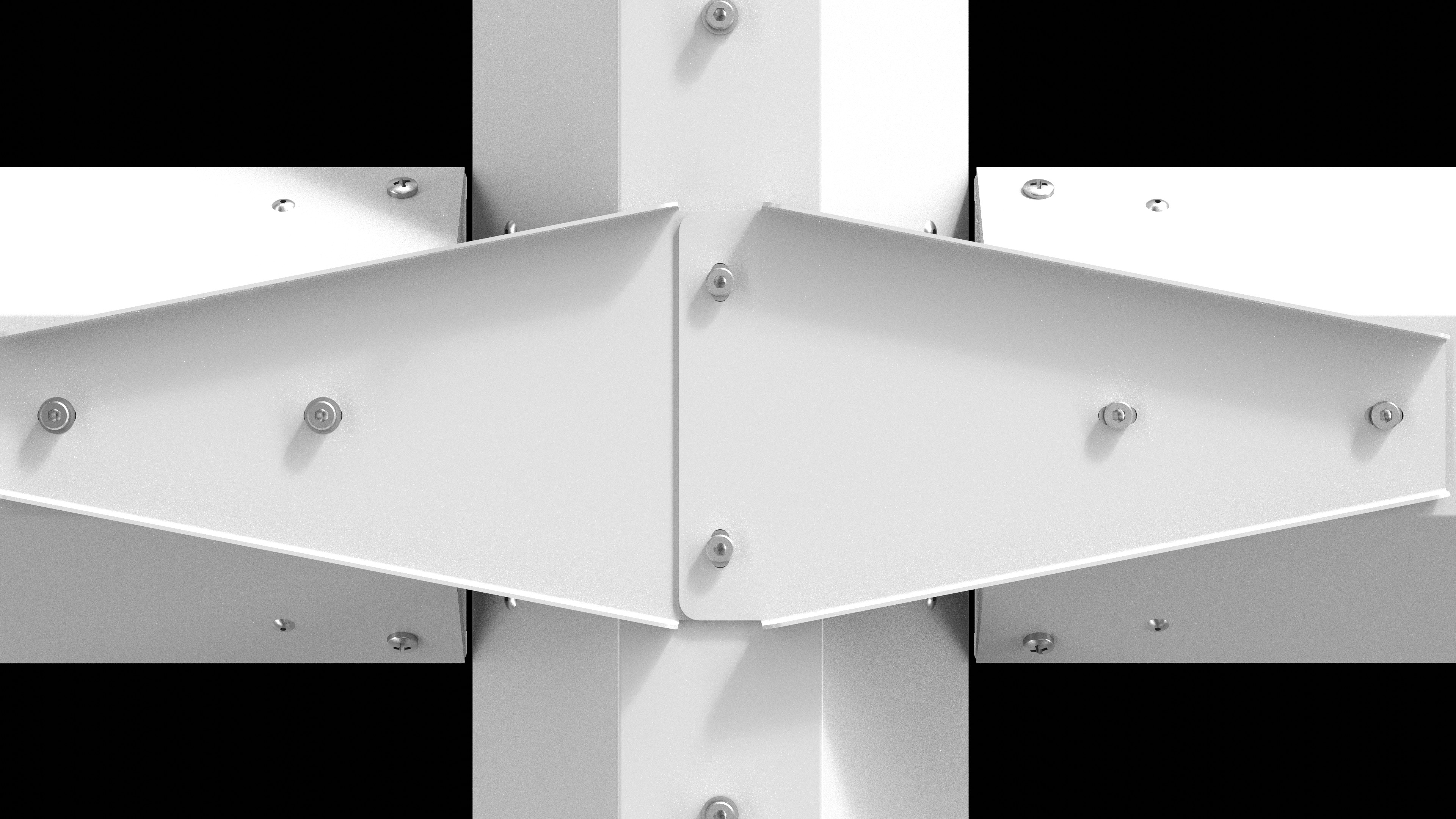

If you switch from CPU to GPU, then artifacts appear.
I know that such artifacts are corrected with Epsilon values.
But, for some reason, I cannot pick them up this time.
Blend file: https://dropmefiles.com/LScwZ

Epsilon
Min: 0.05
Max: 0.5
Result...
PS
Also, w/ this file I noticed that whenever I made a larger/broader Epsilon change, CUDA recompiled from scratch.
Didn't do it systematically, but at random... if anyone is willing to check.

PS.
@Dez!
I would advise to retopo/remesh your geo to prevent such headaches in the future. Elongated (long edged) polys are known to cause shading issues.
;) Keep up the good work.

these values do not work for me.
This model is from CAD.
I plan to render a lot of such models in Luxcore. You need to figure it out, to reach the truth.
Yes, if you do a retopo, then the rendering goes without errors.

:? ok, I also applied Scale and set Camera Scale to 1...
anyways this renders fine on my end w/ Blender 2.83.7_LTS & 2.90.1 using BlendLuxCore 2.5 (latest)
https://dropmefiles.com/GpKFJ

KintuX, thank you, you helped.
I found that you moved the camera closer to the subject and used the Clipping options.
This gave me the idea of looking for a problem in the Clipping parameter of the camera.
Having configured it correctly, the problem disappeared.
I would like to draw the attention of the developers.
If you use these scene settings:
then camera Clipping values require tens of thousands of millimeters
It is curious in this moment that the Clipping parameter can be completely disabled for CPU - everything will work flawlessly. But the GPU requires tuning.
