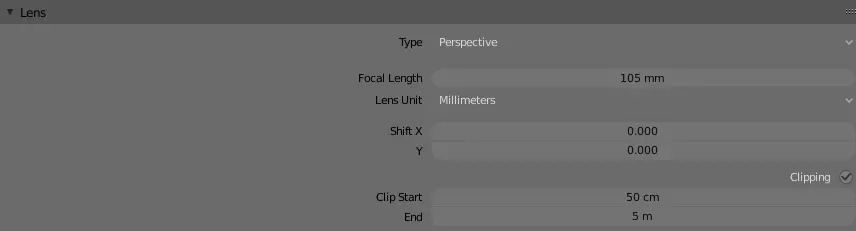

KintuX, thank you, you helped.
I found that you moved the camera closer to the subject and used the Clipping options.
This gave me the idea of looking for a problem in the Clipping parameter of the camera.
Having configured it correctly, the problem disappeared.
I would like to draw the attention of the developers.
If you use these scene settings:
then camera Clipping values require tens of thousands of millimeters
It is curious in this moment that the Clipping parameter can be completely disabled for CPU - everything will work flawlessly. But the GPU requires tuning.

Dez! wrote: Mon Oct 12, 2020 6:07 pm ;)
Right 8-) totally forgot about it, cuz almost every scene I tackle I automatically sanitize first.
Anyways, all of the above mentioned issues stand still.
And about Scene settings > Units, set Length to Adaptive
and you'll get better overview
although, the caveat is it's even easier to miss & forget about FP limits, precision span...
