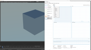

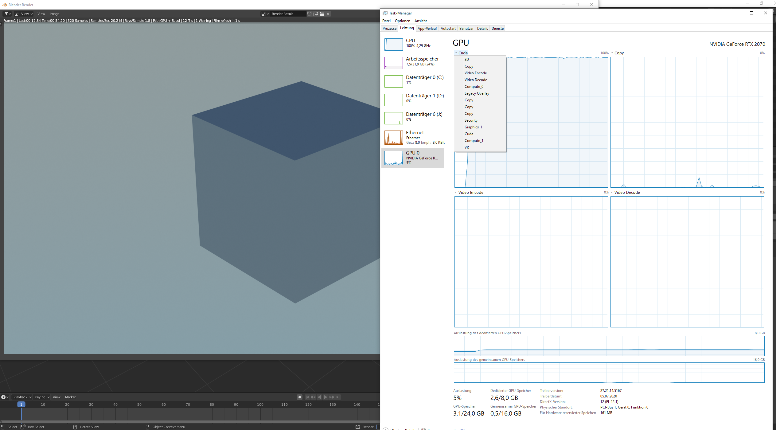

I don't know how the task manager defines GPU usage but this seems to be normal behavior in windows. I also see 0% GPU usage there, and GPU rendering definitely works.
Also you will always get CPU usage because there is auxilliary stuff to do, for example data transfer to the GPU to manage.
Try to render a simple scene (e.g. the default cube) and observe the samples per second for the three possible settings, i.e. CPU only, GPU only, CPU+GPU, you should see a clear diference.
What you should observe in the task manager is a change in the GPU memory. I see it even for the default cube.
EDIT: I just noticed that the task manager offers you a dropdown menu to show different GPU performance aspects. The default is "3D", which shows nothing. In my case, with an NVidia-card, I have to use "CUDA" to see the the GPU being used by LuxCore.
