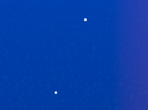

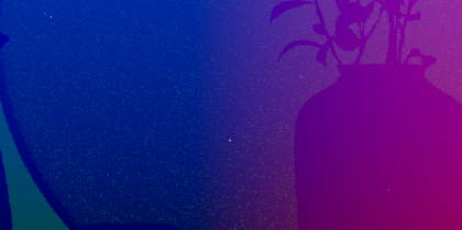

As the picture showing, there are some larger white spots and lots of gray spots in POSITION Channel picture. And there are some black or gray spots in ALBEDO Channel.
What is the reason of this phenomenon。

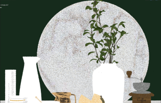

What's more, I also use BlenderLuxCore with 2spp rendering the same scene, and found that those light-colored spots are relevant to some specific material, such as this picture showing(Position channel).
"disconnect the material node of the disc"
"result with the material node--Position channel"
"result without the material node--Position channel"

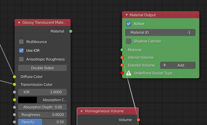

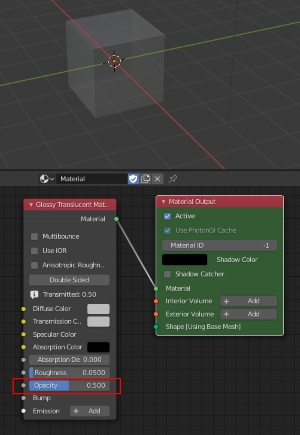

Sorry, I reply to late because of time difference. I follow your advice and try to isolate/simplify the problem, finally, I find that the glossy translucent material node would impact results.
"cube with glossy translucent material node"
Add a cube object and use glossy translucent material node, set "Opacity" to 0.500, then rendering with 2 SPP. I got the the following pitcures.

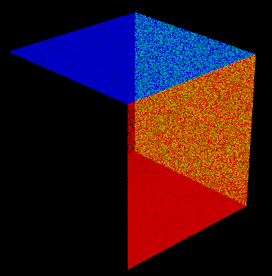

"Shading Normal Channel output"
"Position Channel output"
I would appreciate it if you know the reason for this phenomenon.
Re: LuxCore AOV outputs are strange When using few spp(1spp)
MonkeyDLuffy wrote: Tue Apr 28, 2020 8:02 am Add a cube object and use glossy translucent material node, set "Opacity" to 0.500, then rendering with 2 SPP. I got the the following pitcures.
But if you set opacity to 0.5, it will hit a face of the cube only 50% of the times so this result is normal (or am I missing something ?). This is due to the reason Zeealpal linked as first answer. It is not like the ray color is multiplied by 0.5 and the path always continued, Opacity is really the probability to hit the surface.

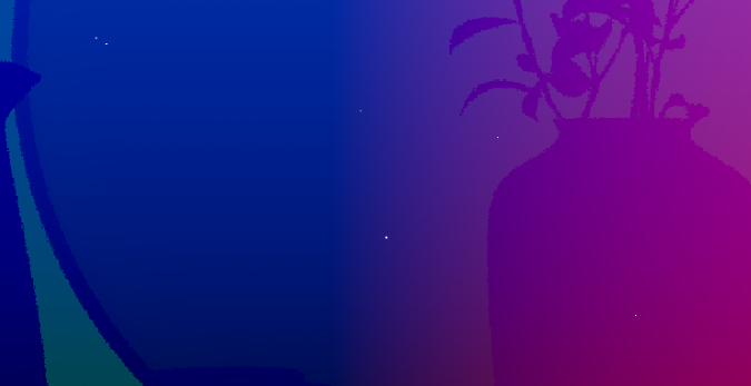

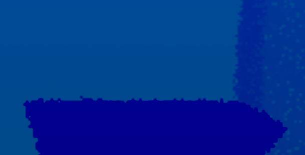

2. I am curious about that the edge of the object is not smooth, as the picture showing.
"the edge of the object"

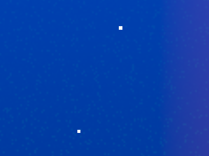

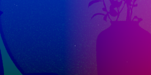

3. I'd like to reconfirm that the reason for this situation, whit and bright spots. After the rendering was over, after a while, I saved the pictures. There still are annoying white spots. Every pixel should has been rendered.
"whit and bright spots"
