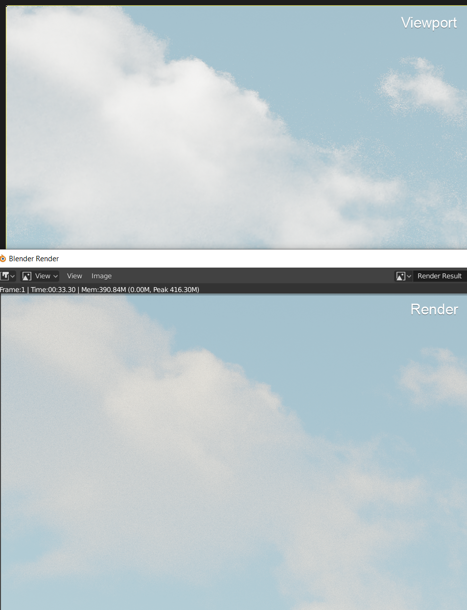

Hi there,
I'm noticing a difference between the viewport and the final render.
I am not using clamping, there is nothing done in Compositing, so I'm not sure why it looks like it's clamping or applying a different tonemap.\
I attached the scene.
lux_core.blend
(1.46 MiB) Downloaded 394 times

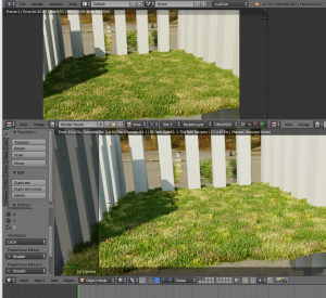

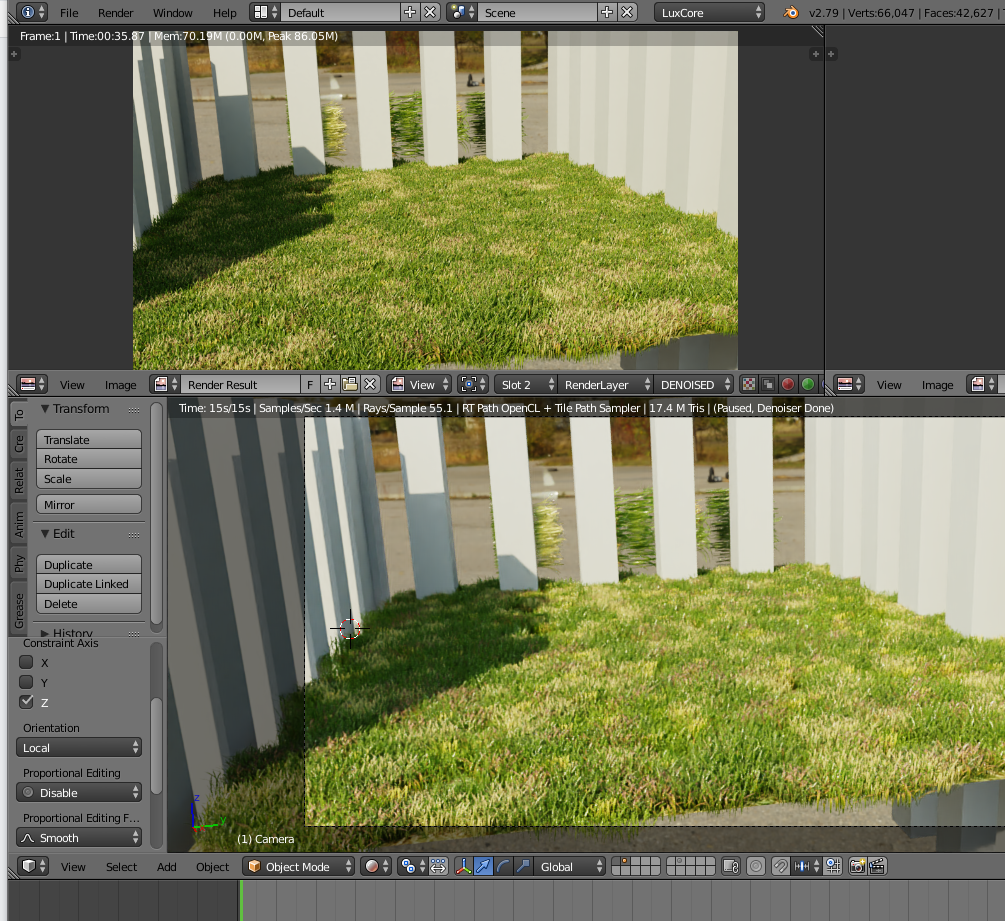

Re: Brightness difference between Viewport and Render
Post by falco »
I have the same problem,best seen in the shadows,
top image is render
down is preview
same settings for both
how to make final render to look like preview render in my case?, it is not just brightness or curve problem
I want to know because overall preview looks much better than render for me
