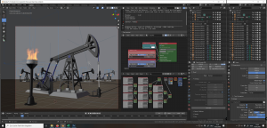

Since Blender 2.82 Material Fire and Smoke does not work: "Object "Cube.Domain" is not a smoke domain!".
Reason is most probably change of fluid physics with last changes in Blender.
See next image for details.
- 2020.03.18_Issue_Fire and Smoke
Please help with support how to make a material based on OpenVDB in current BlendLuxCore or please fix scripts behind Material's button.issue

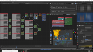

FarbigeWelt wrote: Wed Mar 18, 2020 5:40 pm
I hope the attached example file and screenshot help. If something is not clear, feel free to ask
Re: ISSUE: Fire and Smoke in Blender 2.82
Posted: Wed Mar 18, 2020 8:26 pm
by B.Y.O.B.
Here is another example, this time with fire.
The colors in the band texture are just eyeballed, and I'm not sure what value range is actually in the heat_xxx.vdb files, but it should be a starting point.
Unfortunately mantaflow does not put everything into one .vdb file per frame, it would make the node setups much more convenient.

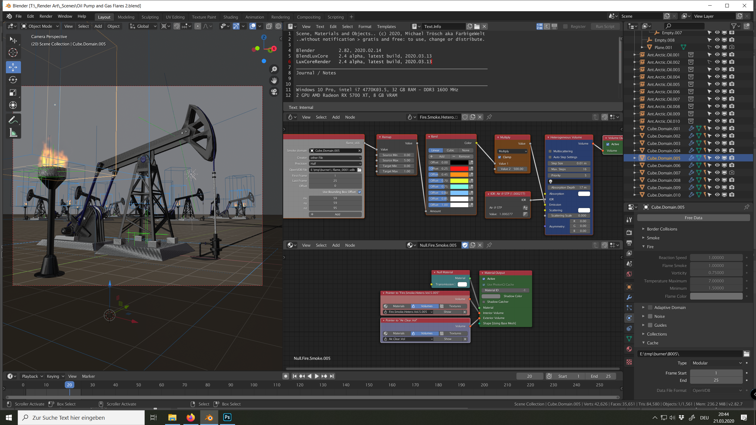

Actually your help is very appreciated but Blender struggled me setting up my scene in a rather lazy way. I first had to understand the handling of fire and smoke. Sometimes smoke and fire showed up and sometimes it did not. Additionally I tried obviously something that worked not reliably.
First, I show the misleading approach putting all domains into one
Volume. It is possible to duplicate a domain but one has to have a separate node
Open VDB File for each domain. By the way, I had to double check menu
Add until I found the require node under
Add>Texture>Open VDB File.
The attachment 2020-03-20 (1).png is no longer available
- All domains in the same Volume and Material
The fires showed up well until I started changing their parameters. After Free Data and Bake again I was not able to reproduce the fires. Quite annoyed I had to bite into the german
sour apple and create for each domain
Material and corresponding
Volume.
And now the final LuxCoreRender with almost all burners active (looks like I missed one).
