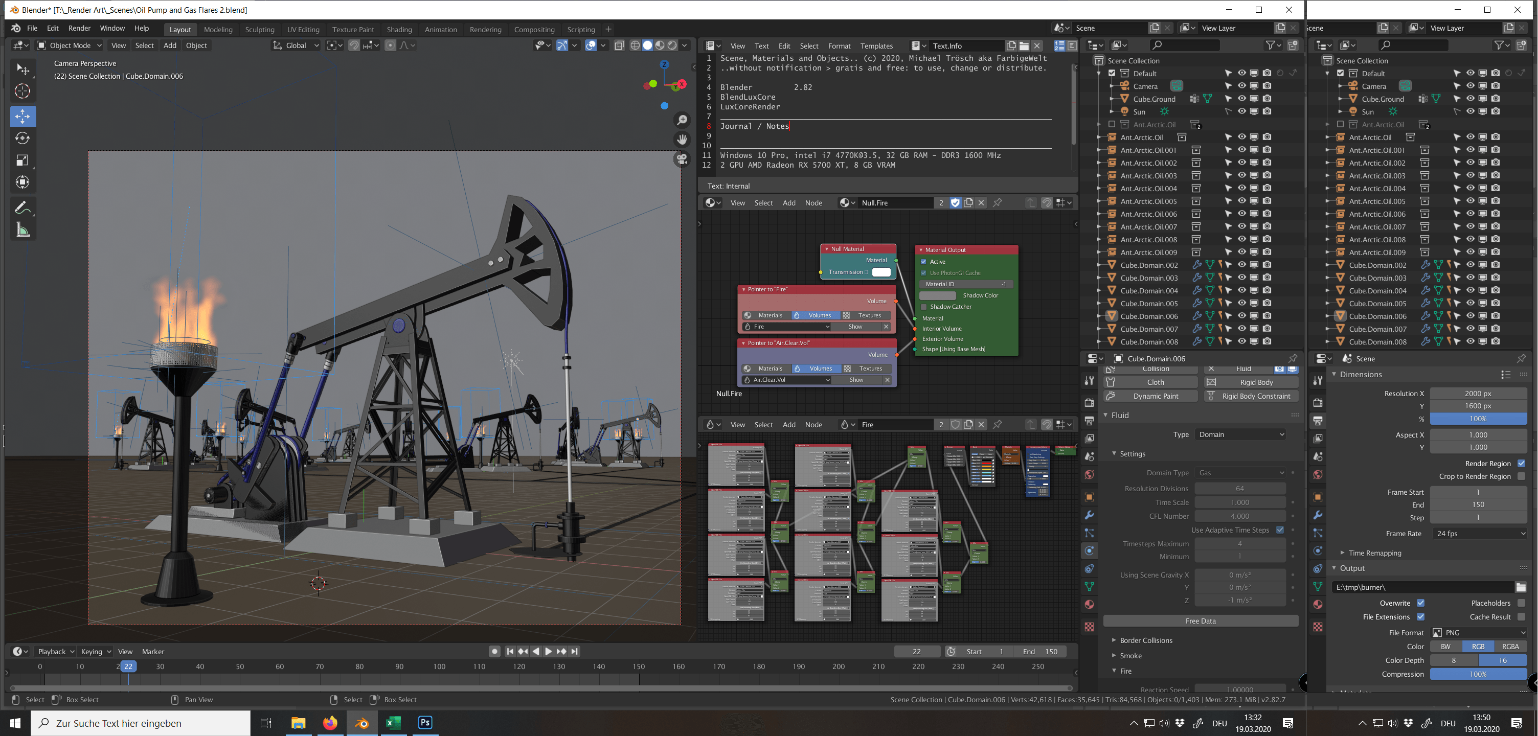

Since Blender 2.82 Material Fire and Smoke does not work: "Object "Cube.Domain" is not a smoke domain!".
Reason is most probably change of fluid physics with last changes in Blender.
See next image for details.
2020.03.18_Issue_Fire and Smoke
Please help with support how to make a material based on OpenVDB in current BlendLuxCore or please fix scripts behind Material's button.issue

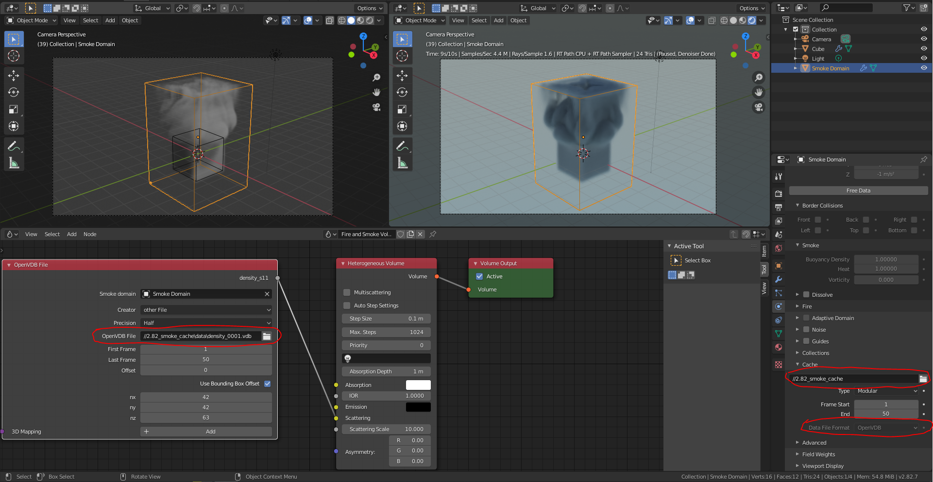

There is an open issue about mantaflow API support: https://github.com/LuxCoreRender/BlendL ... issues/380
FarbigeWelt wrote: Wed Mar 18, 2020 5:40 pm Please help with support how to make a material based on OpenVDB in current BlendLuxCore
I hope the attached example file and screenshot help. If something is not clear, feel free to ask :)
2.82_smoke.blend
Don't forget to bake the smoke before rendering.
(628.58 KiB) Downloaded 361 times

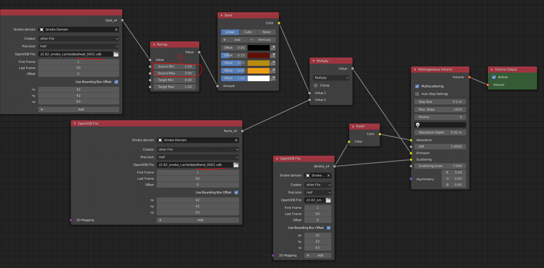

Here is another example, this time with fire.
The colors in the band texture are just eyeballed, and I'm not sure what value range is actually in the heat_xxx.vdb files, but it should be a starting point.
Unfortunately mantaflow does not put everything into one .vdb file per frame, it would make the node setups much more convenient.

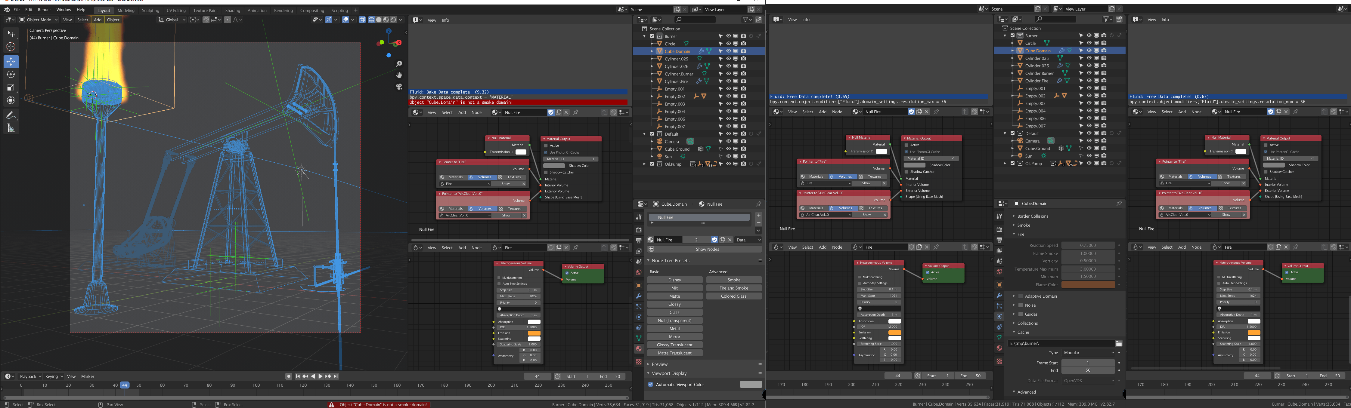

Actually your help is very appreciated but Blender struggled me setting up my scene in a rather lazy way. I first had to understand the handling of fire and smoke. Sometimes smoke and fire showed up and sometimes it did not. Additionally I tried obviously something that worked not reliably.
First, I show the misleading approach putting all domains into one Volume. It is possible to duplicate a domain but one has to have a separate node Open VDB File for each domain. By the way, I had to double check menu Add until I found the require node under Add>Texture>Open VDB File.
The attachment 2020-03-20 (1).png is no longer available
All domains in the same Volume and Material

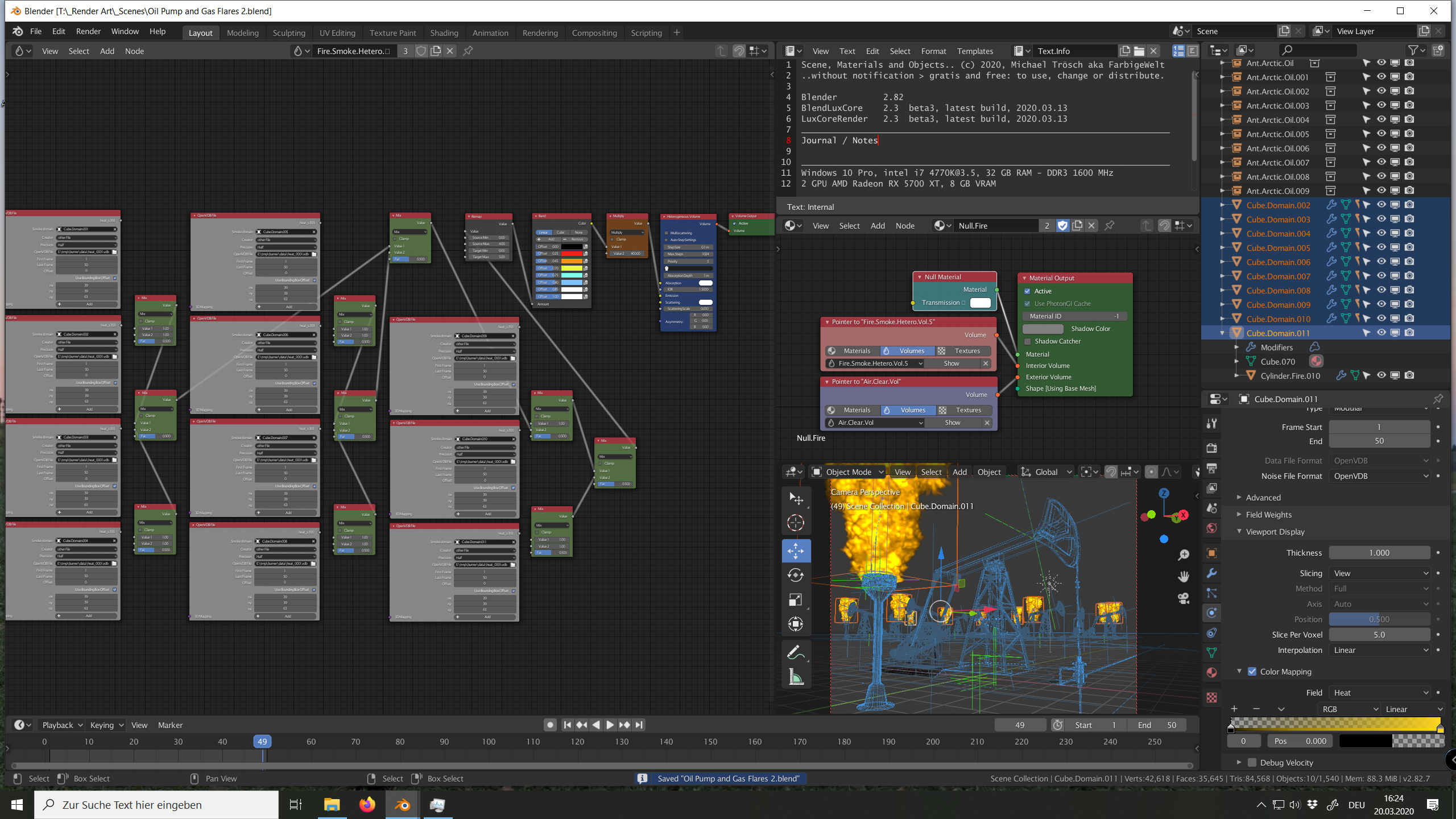

The fires showed up well until I started changing their parameters. After Free Data and Bake again I was not able to reproduce the fires. Quite annoyed I had to bite into the german sour apple and create for each domain Material and corresponding Volume.
And now the final LuxCoreRender with almost all burners active (looks like I missed one).
