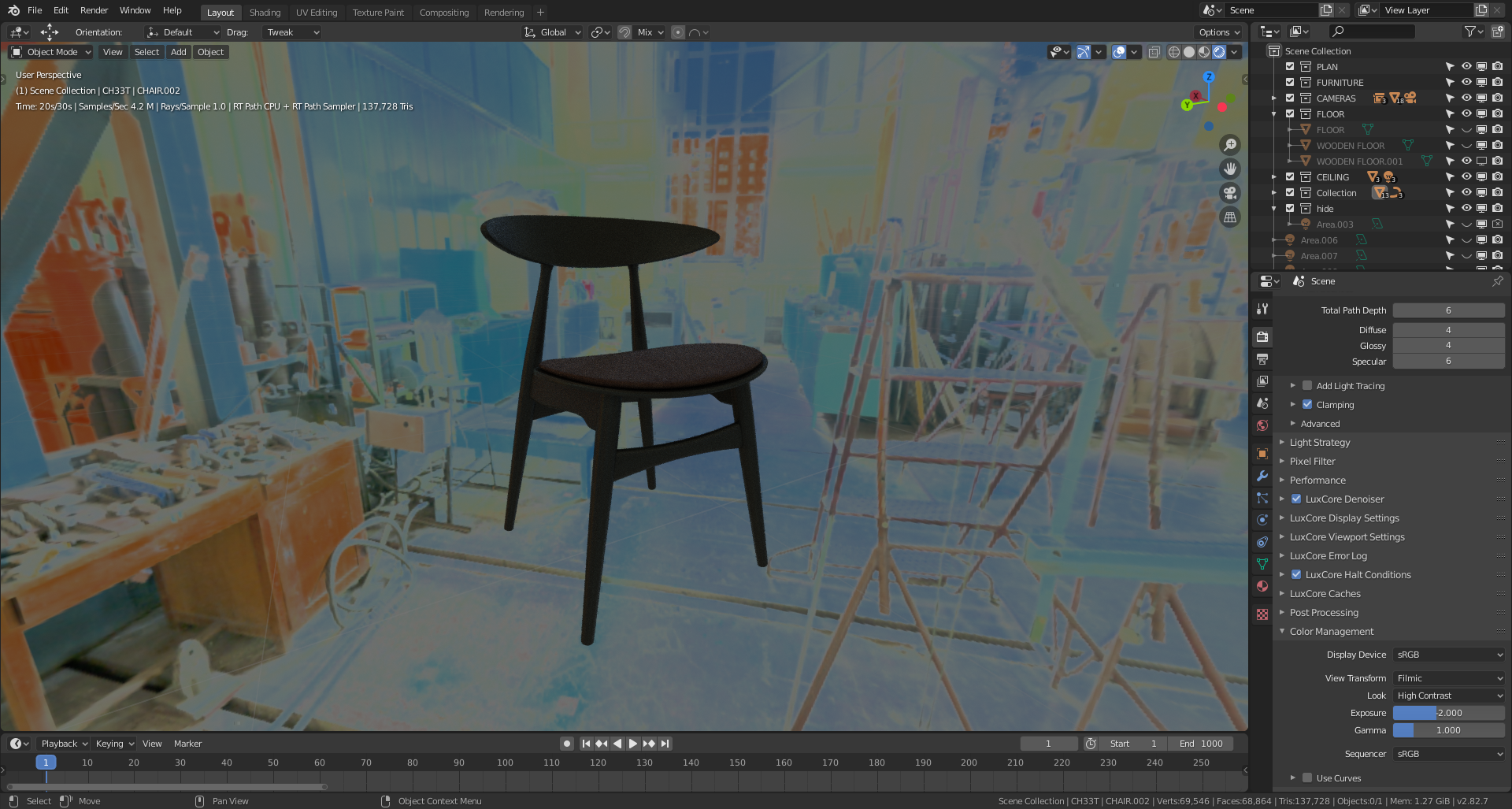

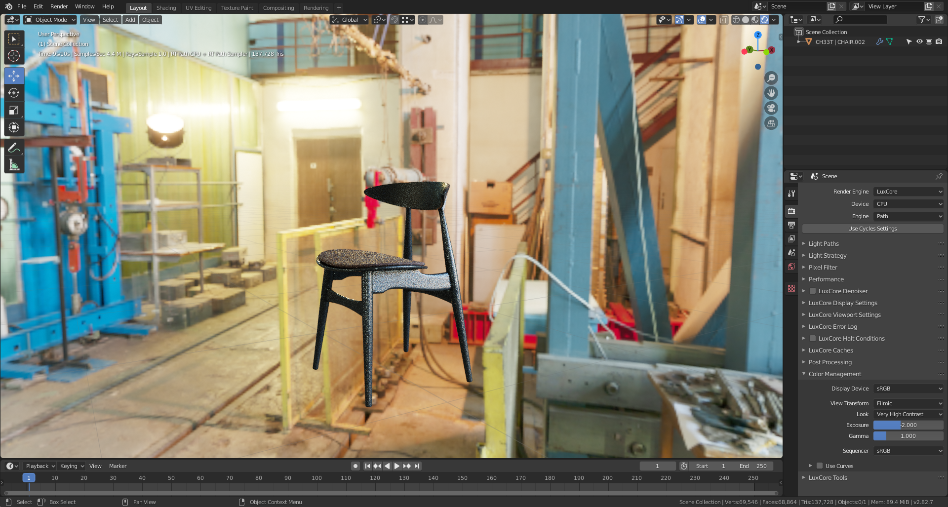

Hi guys, Im having a problem with HDRI ilumintion in a project scene, the colors are inverted and it generates wrong ilumination... In a new scene it is fine. I dont know what I've done! :oops:
Wrong Ilumination in my project scene:
Correct ilumination in a new scene:
Re: HDRI issue in a scene
Can you upload the broken scene?
The clamping value is way too low. It is set to 0.1, while the recommended value is 417.

B.Y.O.B. wrote: Tue Mar 17, 2020 2:12 am The clamping value is way too low. It is set to 0.1, while the recommended value is 417.
Thanks!, it fixed it, but I was using it really well and rendered some images before with that value, thats even the suggested value
The suggested value can only be calculated if clamping is disabled,
You probably calculated it once, then rendered with it, then changed something in the lighting setup and didn't render without clamping since.
Disable the clamping and start a render to get an updated suggested value.
