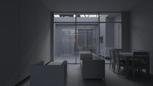

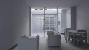

Just continue my testing journey . now while trying to see how much brightness/light detail i can get while increase path deph (same number for all diffuse/glossy/specular) :
8
16
64
128

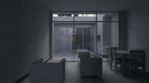

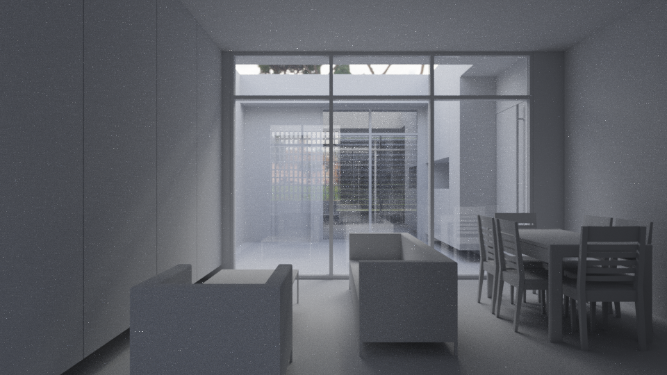

By the way before i change anything in RR default setting here is the light quality difference between Path+PGI vs Bidir. Note how natural / bright / and progressive is the light from Bidir engine .
Bidir
Pathocl+ Pgi
theses kind of light treatment difference lead to a great realism boost ;) look the light in the back of the sofa and also light bouncing on the horizontal grid in front behind the second glass.

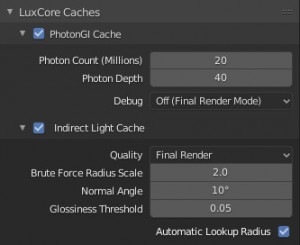

Have you increased the max. photon bounces ?
P.S. BiDir default max. is 16, PGI is 4
Photon deph was set to 40 to avoid any bottleneck :
