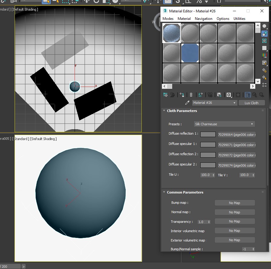

I can not see any issues with the cloth shader?
Loading, saving, colors, textures all fine except the preset that need a fix but no crash at all.
I need a better explanation to reproduce the issue also a debug scene can help.
here is a sample scene with 4k texture and 1000x750 pixel for render size, with almost 1500 pass render, using PathCpu as the engine. save and load render and other things work perfectly.

TAO wrote: Sat Mar 20, 2021 5:26 pm I can not see any issues with the cloth shader?
Renderes it renders fine.. I said if you try to edit the texture, then max crashes.

If you open the mat editor, get into the map for the cloth mat, then try to go up to parent, see highlighte ui icon

patro wrote: Sat Mar 20, 2021 6:43 pm
test lux cloth.zip
it's not about the plugin. i still can not reproduce the issue!!!
Are you sure it is not a bug inside your pc, 3dsmax, or any plugin you have?
