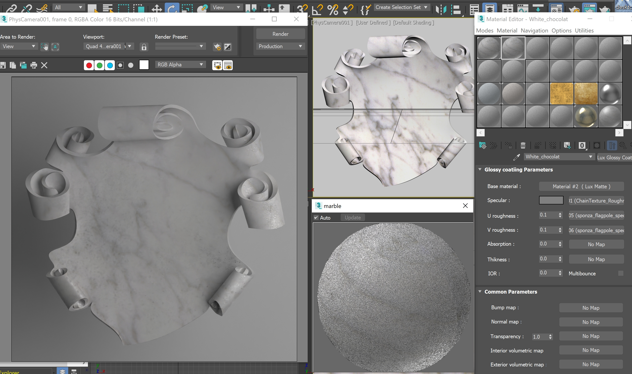

This is my try, as you suggested. texture in roughness and specular map slots.
Of course better than before, but still to me the bitmap keeps looking too light.

there is many ways to fix it.patro wrote: Tue Mar 16, 2021 11:31 pm This is my try, as you suggested. texture in roughness and specular map slots.
I wonder how to do marble, like the one i have at home, where the darker veins are very visible from most every angle.
1- Increase IOR to a high number 3/4/5
2- Increase u/v roughness
3- increase absorption
if you check my last post you will see i suggest you check IOR and other parameters too.
After all, it is a glossy image and shiny surfaces should be brighter than the matte objects.

I thank you very much for your effort in explaing how to set up the material. After several try the only thing which worked is to tonemapa the texture.TAO wrote: Wed Mar 17, 2021 9:22 amthere is many ways to fix it.patro wrote: Tue Mar 16, 2021 11:31 pm This is my try, as you suggested. texture in roughness and specular map slots.
Here a short test with tonemapped texture, just 9 pass only to show for correctness that finally the texture is visble.

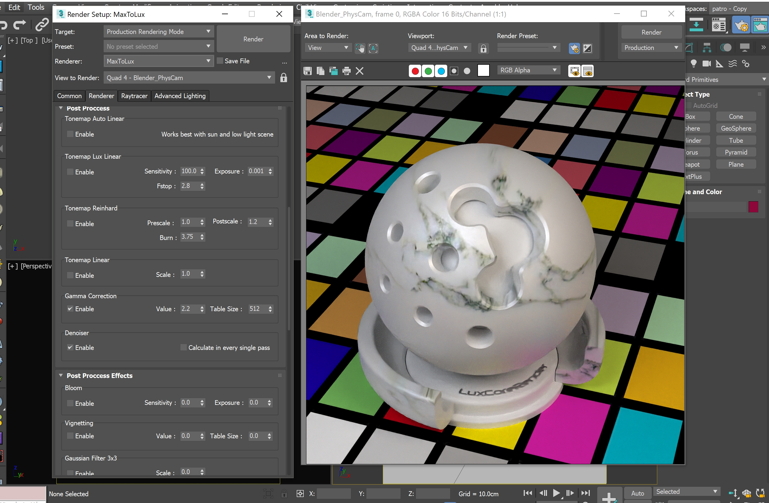

which tonemap you used, can you share a screenshot?
with Gamma Lut disabled. and only mesh lights in the scene
