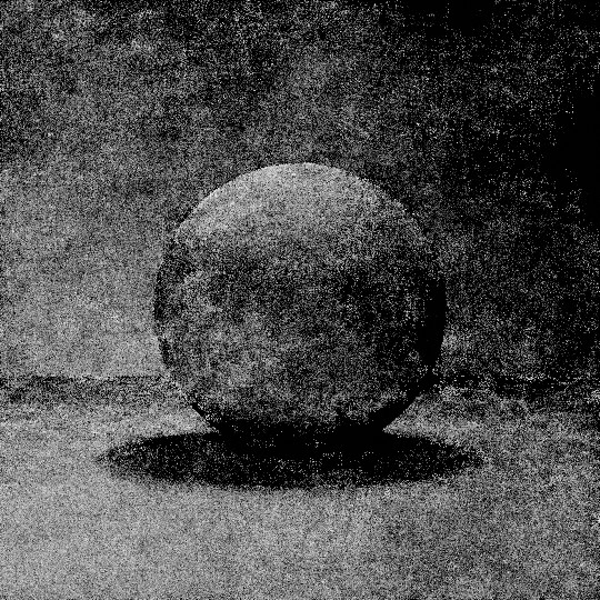

one more light transport tests.
The light has to travel for 6 light bounces before reaching the sphere.
Attached you find the scene.
LuxCore bidir 24 bounces 60 seconds.
Maxwell ???bounces 60 seconds.

I cannot do this tests with other engines, maysome else can try using the files i shared.

daros wrote: Sun Jul 11, 2021 6:42 pm I cannot do this tests with other engines, maysome else can try using the files i shared.
Just tried with cycles and Luxcore path tracer it almost impossible to see somthing.
Only luxore path/Bidir + metropolis and Luxcore GI cache is able to see in the Dark :lol:
All run for 30scs on laptop cpu

Like in my previous test cycles seem to catch more light even on pure path.
sure Gi cache on luxcore close the battle but wonder why it is like that on path only mode.

The first test was simply a meandering tunnel with some small windows on it showing the light travel.

Hi Charles, if you give some color to the emitters you can also verify if the other engines loose light colour during travel, like maxwell.
