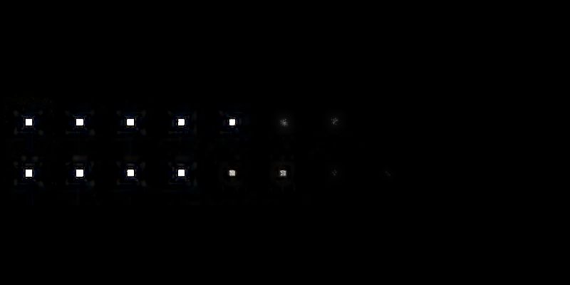

Hi, think this kind of tests have to be kept as simple as possible in order to isolate one specific engine behaviour.
Emitter has 1.000.000 lumen which is a lot for such a small object. It has to be exaggerated precisely to highlight the internal bounce limitation.
Both 60 seconds renderings.
This is Maxwell Render which claims unlimited light bounces :)

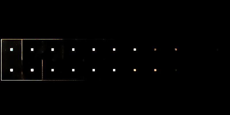

This is Luxcore with only 24 bounces... ohhhhh look at that! Infinite<24!

a part from the wired artifact of the light passing through coincident edges, luxcore even maintains the correct light color tint...maxwell not.
In my opinion Luxcore plays in a different liga and this has to be explained.
