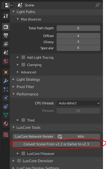

I have started to write a script that converts old scenes to v2.3.
The code can be found here: https://github.com/LuxCoreRender/BlendL ... ibility.py
Still missing is tonemapper conversion (a very hard to solve problem) and light settings conversion.
@chafouin: Can you help me with the conversion code for regular lights?
I.e. convert from the old broken "gain + power + efficacy" to the new settings?
It is available under the new "LuxCore Tools" panel in the render properties:

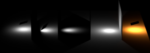

I have created a testscene, this is how it looks in v2.2:

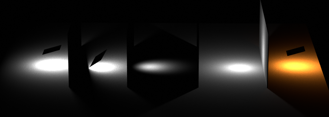

This is how it looks in v2.3, with no conversion performed:

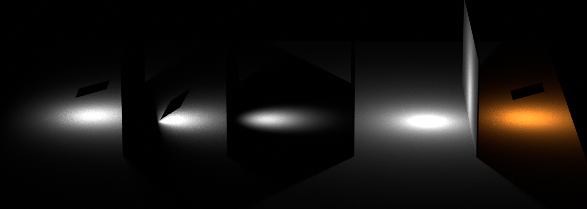

Now with the conversion operator, as it was after your pull request (your code not being executed, and my code disabling blackbody normalization):
And this is the result after I changed some code so your area light conversion is performed:
