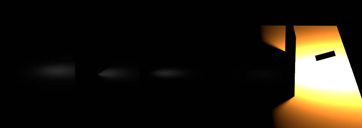

I have created a testscene, this is how it looks in v2.2:

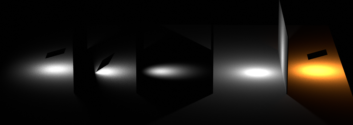

This is how it looks in v2.3, with no conversion performed:

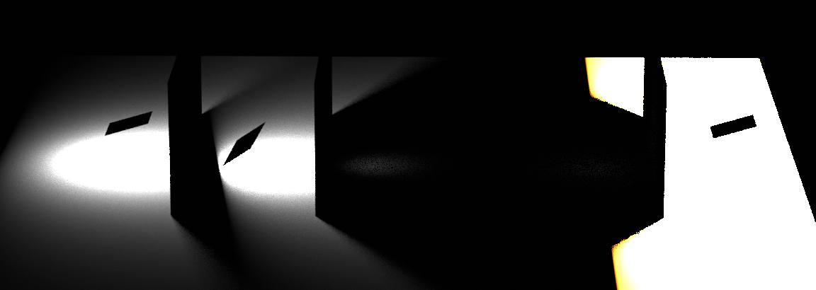

Now with the conversion operator, as it was after your pull request (your code not being executed, and my code disabling blackbody normalization):
And this is the result after I changed some code so your area light conversion is performed:

Re: Light intensities and matching Cycles
Got a bit further, now multiplying in the old gain:
https://github.com/LuxCoreRender/BlendL ... ity.py#L45
But there's still a slight difference in area light brightness.
