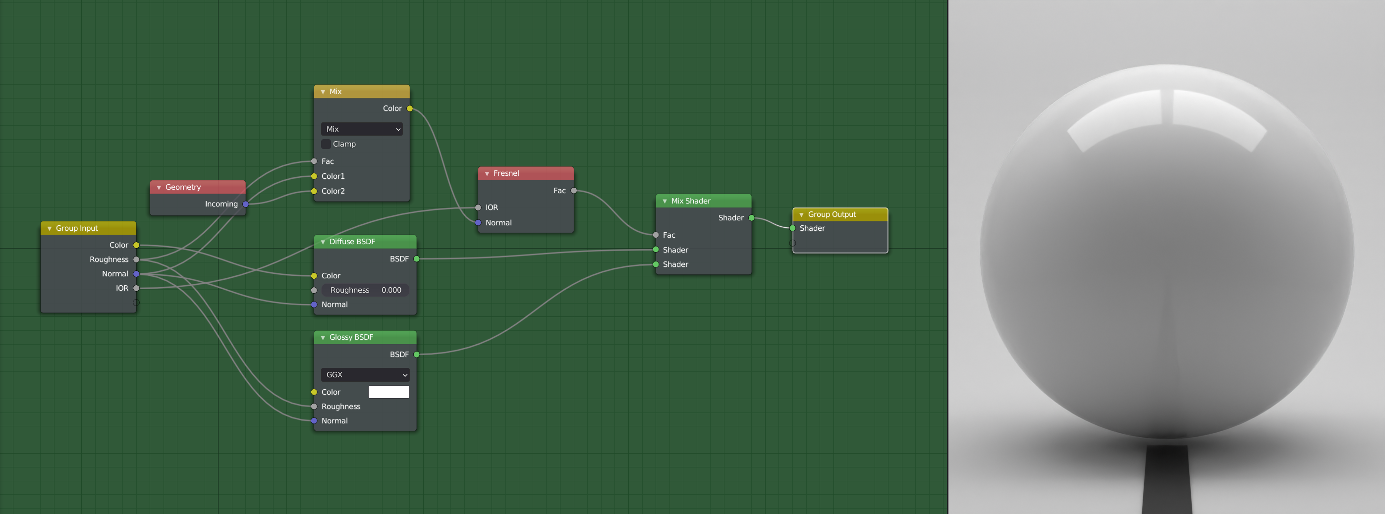

Have been running into this same issue off and on again...I was able to create a Cycles dielectric node that seems to fix the problem (image/scene file attached). Overall light reflectance seems to drop
very slightly but results are certainly comparable to the Principled/Disney node. I've also tested it in a "white furnace" scene and results appear to be accurate regarding energy conservation. I realize I'm posting this in a LuxCore forum, but wanted to reply as I thought perhaps it could be useful to other people running into this issue and maybe even useful to LuxCore devs somehow (though I'm really not sure how it would be...it's a basic diffuse/glossy mixed by roughness-dependent fresnel).
EDIT: Realized there was an issue with how I was calculating roughness-dependent fresnel in original upload...fixed screenshot and scene file attached
