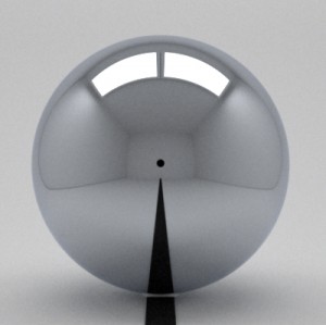

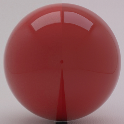

But first let's take a look too some photos of the real materials samples we did in our sampler box.
Lime Glazed ceramic
Red carpaint
Chrome

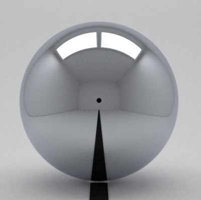

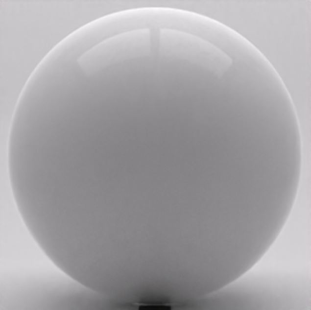

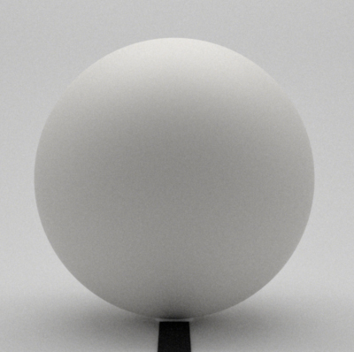

And this is Mitsuba
White matte
White ceramic
Red carpaint
Chrome
As you can see the mitsuba results catch almost perfectly the fresnel of our photos. The differences are related more to gamma settings and to light distribution since the mitstuba tests are done in path tracing.
Lime Glazed ceramic

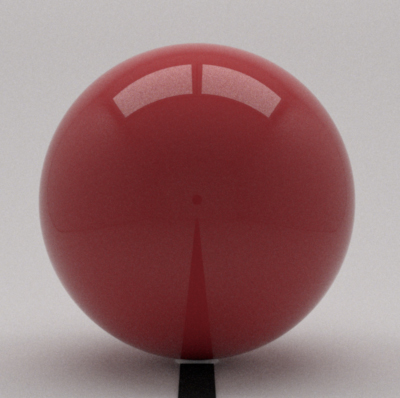

Red carpaint
Chrome
And this is Mitsuba

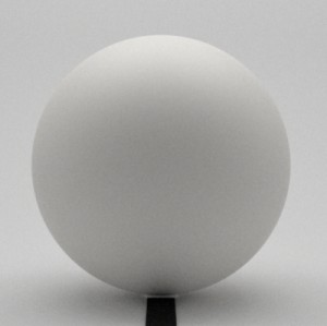

White matte

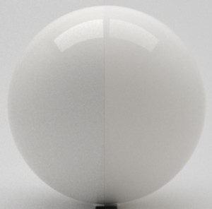

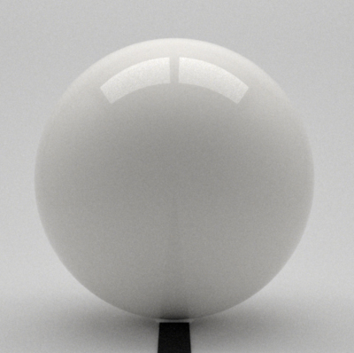

White ceramic

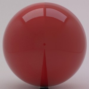

Red carpaint

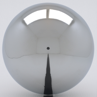

Chrome

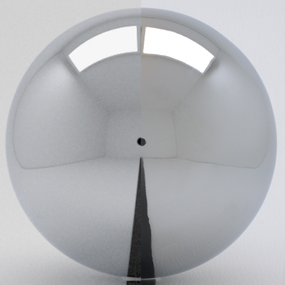

Re: Specular reflection vs diffuse reflection.

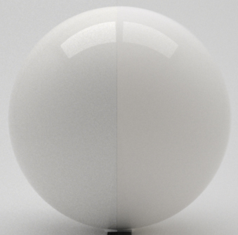

with some minor gamma and exposure correction i got this:
Left hemisphere Mitsuba, right hemisphere real photo.
