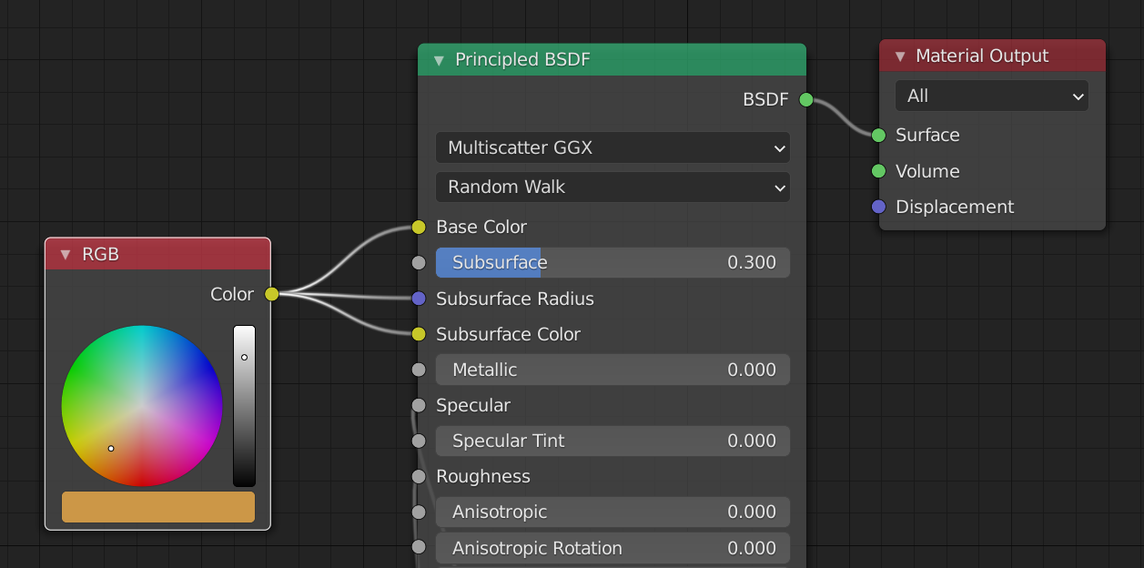

Sharlybg wrote: Tue Nov 03, 2020 6:13 pm Can you just make a simpe scene of your Cycles SSS applied to luxball so that we can just convert it to Lux for you ? :idea:
There's no special node setup. Here's how the SSS material looks in Cycles:
Thanks in advance if you want to give it a try.

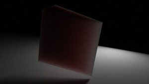

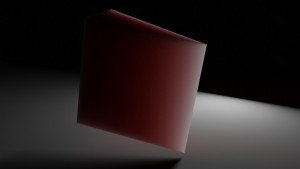

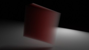

I have created a simple testscene.
In Cycles, the SSS is done with a principled (aka disney) shader.
  • Subsurface is set to 1.
  • Subsurface Radius is (1, 1, 1).
  • Subsurface color is red.
Note: In Cycles, the "Subsurface" slider is a multiplier for the subsurface radius. The radius itself is effectively RGB, meaning if you set it to (1, 0.5, 0.5) for example, red light will be scattered further than green and blue. See also https://docs.blender.org/manual/en/late ... ipled.html
Cycles
Cycles
I am not totally sure how to translate Cycles subsurface radius to LuxCore terms, so I just eyeballed the following and it seems to match:
  • Material null (so I can concentrate on the volume only first).
  • Homogeneous volume.
  • Multiscattering enabled (can't match Cycles otherwise, the volume stays too dark).
  • Absorption color set to the same red as Cycles.
  • Absorption depth is the max. thickness of the cube, 0.8 m.
  • Scattering color white.
  • Scattering scale 10.06.
Lux, only volume (null surface)
Then, I tried to add the surface material. I think the most fitting thing would be glossytranslucent here, but even with diffuse color = black and transmission color = full white, it darkens the result considerably.
Lux with glossy translucent surface
Note also that the path depth is important. Below a depth of 14, you can see visible darkening in the volume. I set the depth to 16 for all ray types in LuxCore.

Yeah, the SSS Radius is an RGB value. I often plug the color in that slot as well, to emphasize the SSS color, as the RGB node has a three-fold vector output corresponding to the SSS Radius RGB channels.
