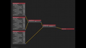

Might be the right time to introduce kind of brdf node that allows to define the portion of scattering types (matte, glossy, specular) per incidence angle. Ideally with some optional interpolation types (e.g. linear, exponential etc) between those points.
What do you think?
BR
Re: Angular roughness/Angular glossiness
Posted: Thu Jul 23, 2020 2:16 pm
by lighting_freak
lighting_freak wrote: Mon Jul 20, 2020 3:44 pm
- maybe like this?
