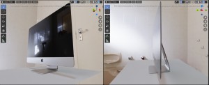

If not, how did Sharlybg make these screenshots?

It's the usual fresnel effect (angular specularity if you will), but it's not angle-dependent roughness.
