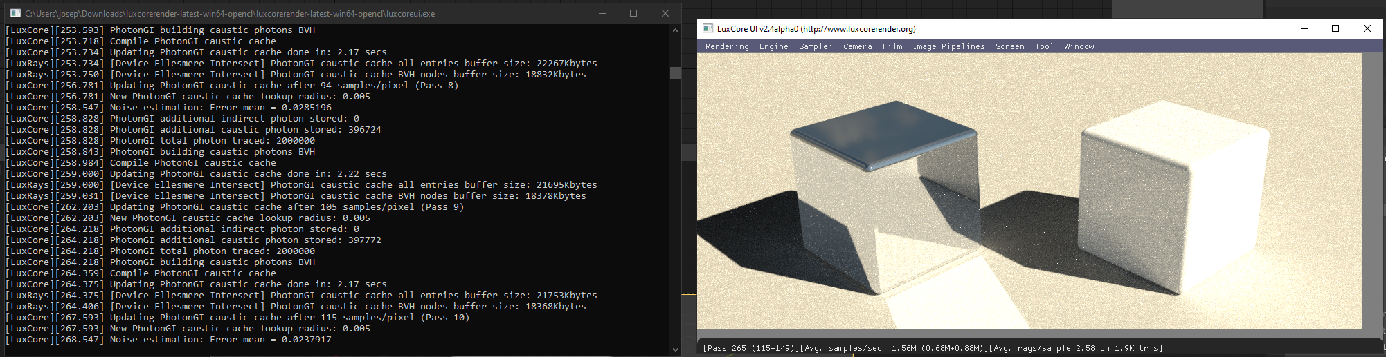

Yes it does, but I'm sure it's not using that. OpenCL device is labelled as "Ellesmere".
I also tried rendering with Luxcore standalone, same image.

jgrover110 wrote: Fri Apr 10, 2020 12:16 pm I also tried rendering with Luxcore standalone, same image.
Don't they look quite different (original problem screenshot Vs. stand alone) ?
The shadow in the first one is pitch black, I can get the same result if I set the number of CPU threads to 0. I will check again if I can reproduce this problem in some way.

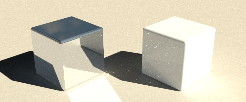

For sake of comparison, here is the render in Blendluxcore without ACES, only sRGB.

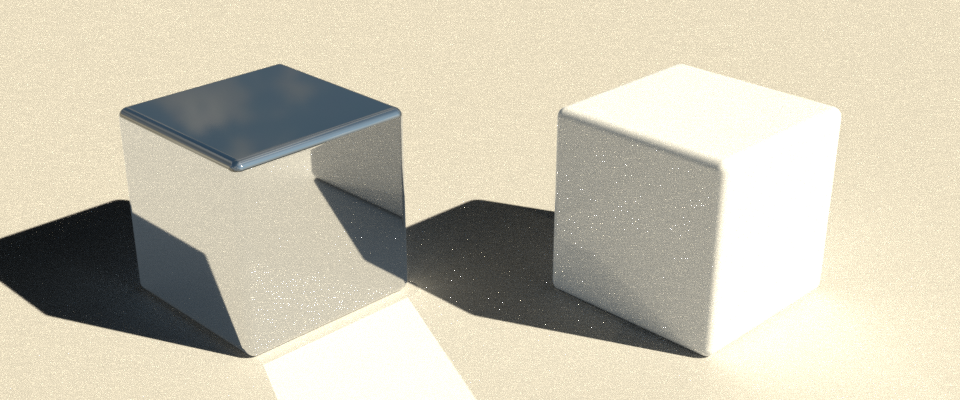

This is a rendering with Caustic Cache disabled. This shows that the Light Tracing is working as there is a caustic from the metal cube, yet the shadows are still incorrect.
Re: HDRi and Light Tracing
jgrover110 wrote: Fri Apr 10, 2020 1:45 pm This is a rendering with Caustic Cache disabled. This shows that the Light Tracing is working as there is a caustic from the metal cube, yet the shadows are still incorrect.
I have some serious trouble to notice any difference (aside from SDS paths) :?: What do you mean with incorrect shadow exactly ?

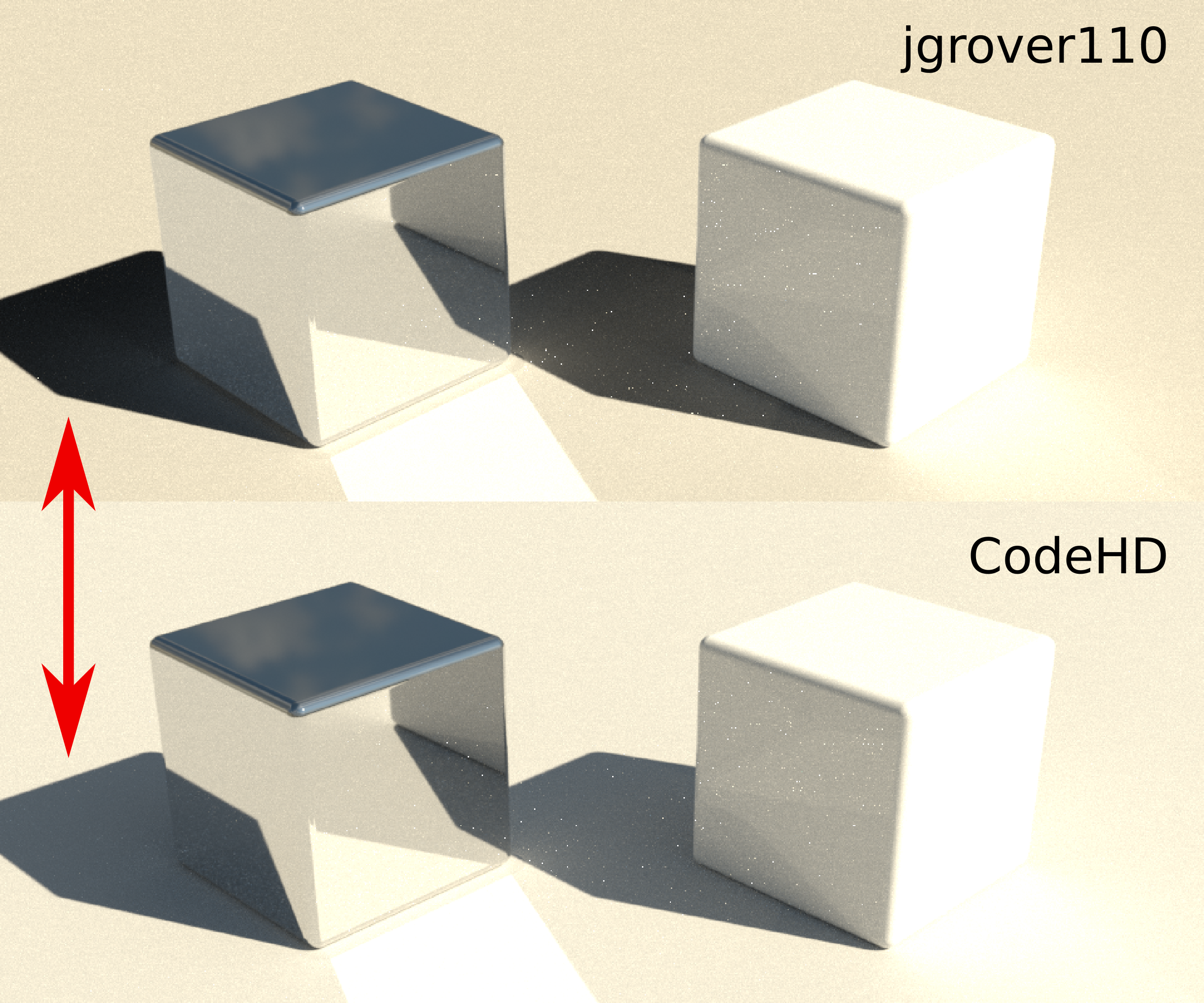

Here is a side-by-side comparison.
Still a tiny bit of color difference of the background plane but I think we can agree the shadow difference goes beyond that.
I could not replicate it (from within Belnder) with some settings variations (cpu/OCL, light tracing on/off, cache on/off)
