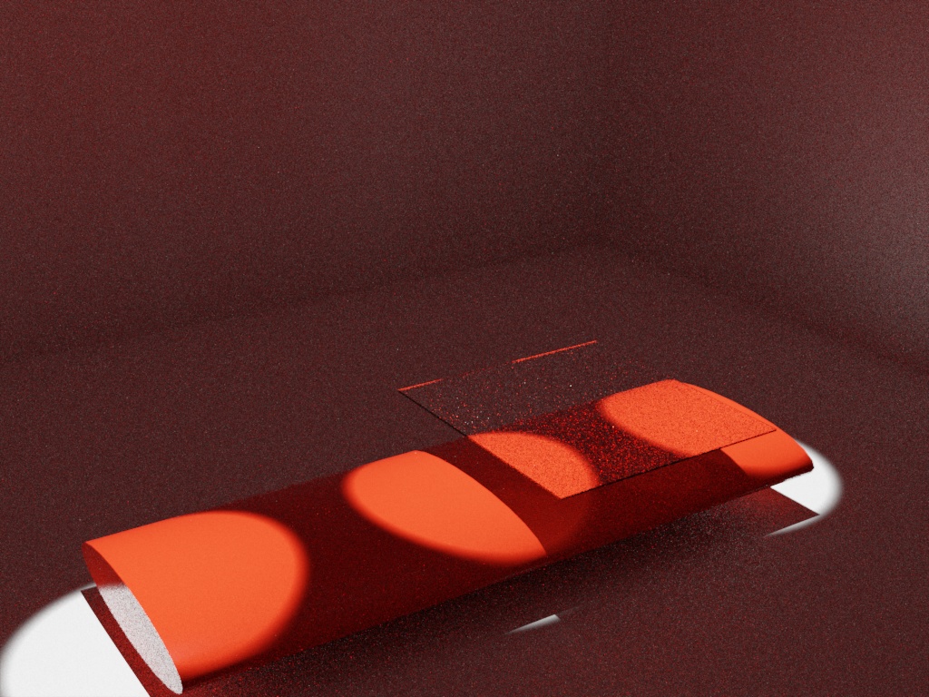

For this reason the scene i so basic. It fucus only on this specific prolem so the debug is easier. Despite it's non orthodox modelling it behaves exactly every other scene i have. The walls without thickness do not disturb since the environment is pure black. There are no polygon intersections enywhere in the scene.
Moreover the problem is so simple that everyone who has blender can reproduce it in 30 seconds, 1 box, a plane and one spot light. You should notice the same bahviour.
Here i completetely removed the box
Bidir on cpu
The shadow you see behind the glass is correct but the one you see directly projected on to the red object is solid, which is wrong.
Isted if you do the same using PhotonGI you should get the other behiaviour i described in my previous post.

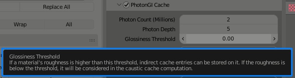

aha, bidir has too high PGI Glossines treshold set so no SDS paths
now, results match 8-) (disregarding brightness)

Making PGI glossiness threshold to zero doesn't change anything in version 2.61, also disabling PGI doesn't work either. Only in version 2.5 that Bidir doesn't work with PGI i get a correct matching result.

Luximage wrote: Sun May 01, 2022 1:45 pmMaking PGI glossiness threshold to zero doesn't change anything in version 2.61, also disabling PGI doesn't work either. Only in version 2.5 that Bidir doesn't work with PGI i get a correct matching result.
Oh, I didn't set it to zero, but 0.005 just lower than that of Red Disney Material - it's Blender merely showing 3 digits :roll:
Edited file attached.

Hello kintuX thank you for the file, the difference in your file is not the glossiness threshold but enabling caustic cache and setting glass shadow color to black not to white.
