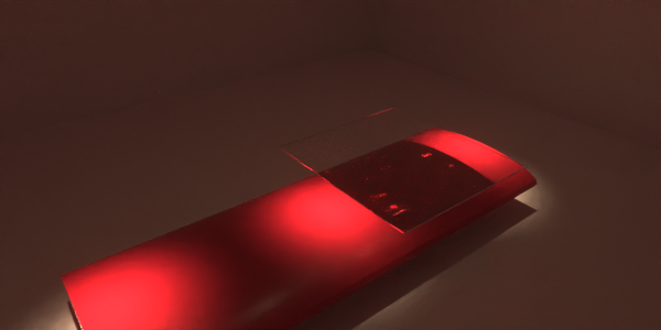

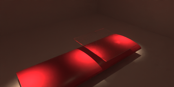

Hi do you experience the same problem with shadow color?
bidir cpu - normal shadow color
this one is as expected by knowing the caustics-through glass problem
bidir cpu - white shadow color
should not cast shadow on the red object
PhotonGI on CPU glass normal shadow color
https://drive.google.com/file/d/1s02Zb8 ... sp=sharing
It increases the brightness of the area below the glass which is not expected.
\https://drive.google.com/file/d/1-vMFfh ... sp=sharing

Re: shadow color for glass issue
Is the shadow color 100% white in both cases ?
Posts: 309
Hi sharlybg, it is full white in the second and in the fourth example. In the first and the third it is black.
