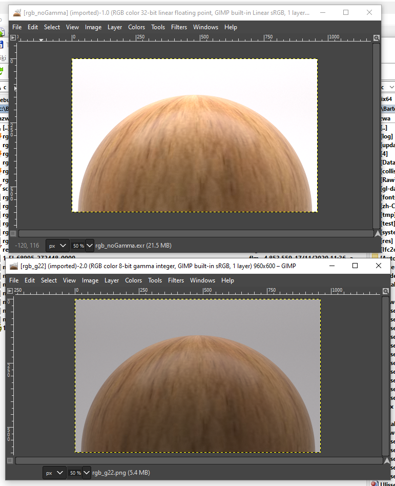

1. I don't think my gimp is wrong. Previously I had gimp v2.10.18. Now I have updated to v2.10.22. The result is the same. If I open with XnView it is still the same.
2. Removing gamma correction from pipeline does not change anything. Gamma 1.0 == no gamma correction. This make sense.
3. In my opinion png with gamma 2.2 (file rbg_g22.png) should be identical to exr with gamma 1.0 (file: rgb_noGamma.exr) but hey are not:

bartek_zgo wrote: Tue Nov 24, 2020 1:17 pm 3. In my opinion png with gamma 2.2 (file rbg_g22.png) should be identical to exr with gamma 1.0 (file: rgb_noGamma.exr) but hey are not:
No. PNG is a file format with values between [0.0, 1.0] while EXR is a file format with values between [0.0, +INF]. PNG with gamma X will look like EXR with gamma X if and only if EXR values are mapped between 0.0 and 1.0 (where X is whatever you want).
PNG is a LDR format, EXR is an HDR.

No, I didn't modified anything. I used an option to tell exrdisplay what is the min and max value to use: you can not apply gamma correction to an infinite range, you need to have a finite range, a min (usually 0.0) and a max (usually 1.0).
bartek_zgo wrote: Wed Nov 25, 2020 8:17 am Why you can not save exr files already normalized? Is there a good reason to do this while opening, not while saving?
Because they would be a LDR instead of an HDR image. It would the same of a 16bit PNG and it is not how EXR is intended to be used.

bartek_zgo wrote: Tue Nov 24, 2020 2:47 pm So to get the same result I have to map maximum value in exr to 1 and after this apply gamma correction.
You might still not end up with exactly the same result as the LuxCore output, because LuxCore doesn't apply normalisation but a scaling factor that depends on gamma. (Normalisation doesn't really make sense anyways because you would lose control over the image brightness.) You can see the source code fo that factor here.
If we compute the ratio of this factor for gamma 2.2 and 1.0 we get 0.39.
To demonstrate the impact, I used the "rgb_noGamma.exr" from your scene and processed it in python in two ways to compare with the LuxCore:
First, I normalized the EXR, then applied gamma. Second, I scaled the image by a factor 0.39 as explained above, then applied gamma.
here is the result compared to the direct output from LuxCore:
