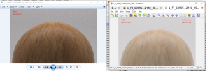

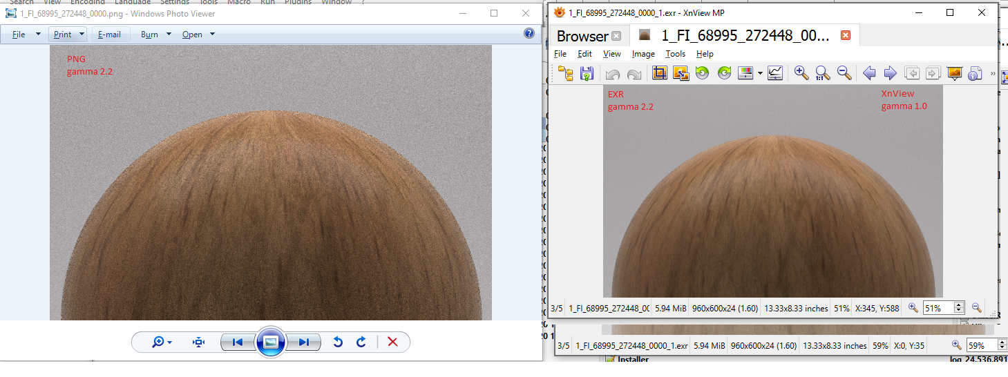

Than I've changed extension to exr: As you can see the colors are washed out. This is because I have gamma 2.2 in exr and than XnView apply again gamma 2.2
So I remove gamma correction from XnView and get correct image: But this is not in 100% correct. Exr images should be saved with gamma 1.0, because all software (XnView, Gimp, Photoshop) apply 2.2 gamma correction to exr images. So logical solution is set 1.0 to gamma correction in image pipeline. But I get something strange: Could somebody explain to what I'm doing wrong? From my point of view, id should identical if I apply gamma correction during save process or read process as long as I apply it only once.

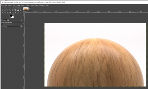

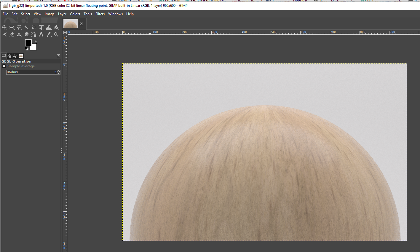

Than I have 2 exr files. One with gamma 1.0 another with gamma 2.2. If if open them with gimp neither of them lool like png file, but they should.
I mean. The exr with gamma 2.2 will not be correct, as gimp applies gamma correction 2.2 wile opening exr files. So in this case we have to times 2.2 gamma applied. But with rgb.exr (that has gamma 1.0) opened with gimp that applies gamma correction 2.2 I should see exactly the same result as rgb_g22.png.
I can not attach exr files so I send screens of this files opened with gimp.
