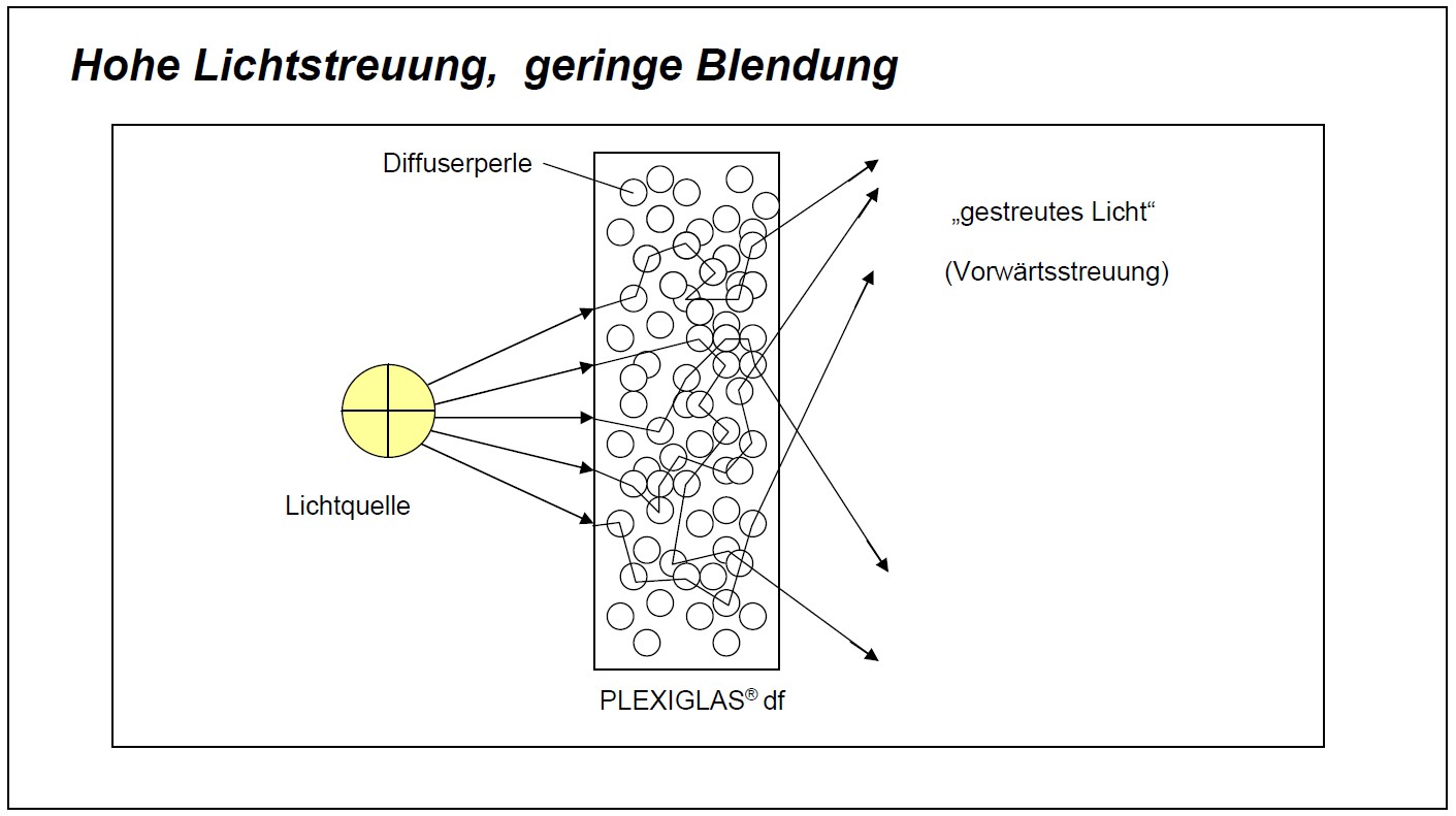

sure I can try to describe the meaning:
Let's start with "8N" - it is the clear basic PMMA material.
The "DF_XX" is the density of light diffusing elements within this basic acrylic. The higher this number the more diffuse the volume is.
There are some images that show some key facts to the pure (not satiniced, but polished surface) material (sorry that they are in German):
This is how it works:
This is how diffusion is defined and measured:
They measure the angle that shows a light intensity fall-off to 50% of its highest intensity at normal view.
The diffusion angle is given as "half width half max - HWHM".
This are the results for vayiing DF materials:
I hope this helps to understand the volume.
