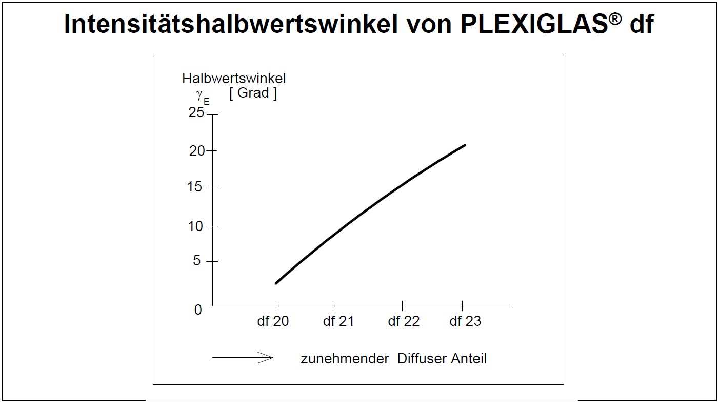

sure I can try to describe the meaning:
Let's start with "8N" - it is the clear basic PMMA material.
The "DF_XX" is the density of light diffusing elements within this basic acrylic. The higher this number the more diffuse the volume is.
There are some images that show some key facts to the pure (not satiniced, but polished surface) material (sorry that they are in German):
This is how it works:

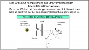

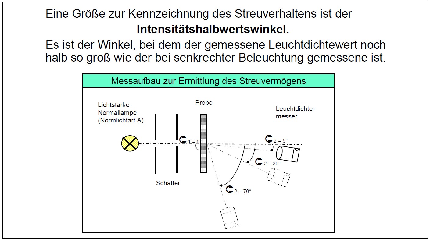

This is how diffusion is defined and measured:
They measure the angle that shows a light intensity fall-off to 50% of its highest intensity at normal view.
The diffusion angle is given as "half width half max - HWHM".
This are the results for vayiing DF materials:
I hope this helps to understand the volume.

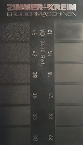

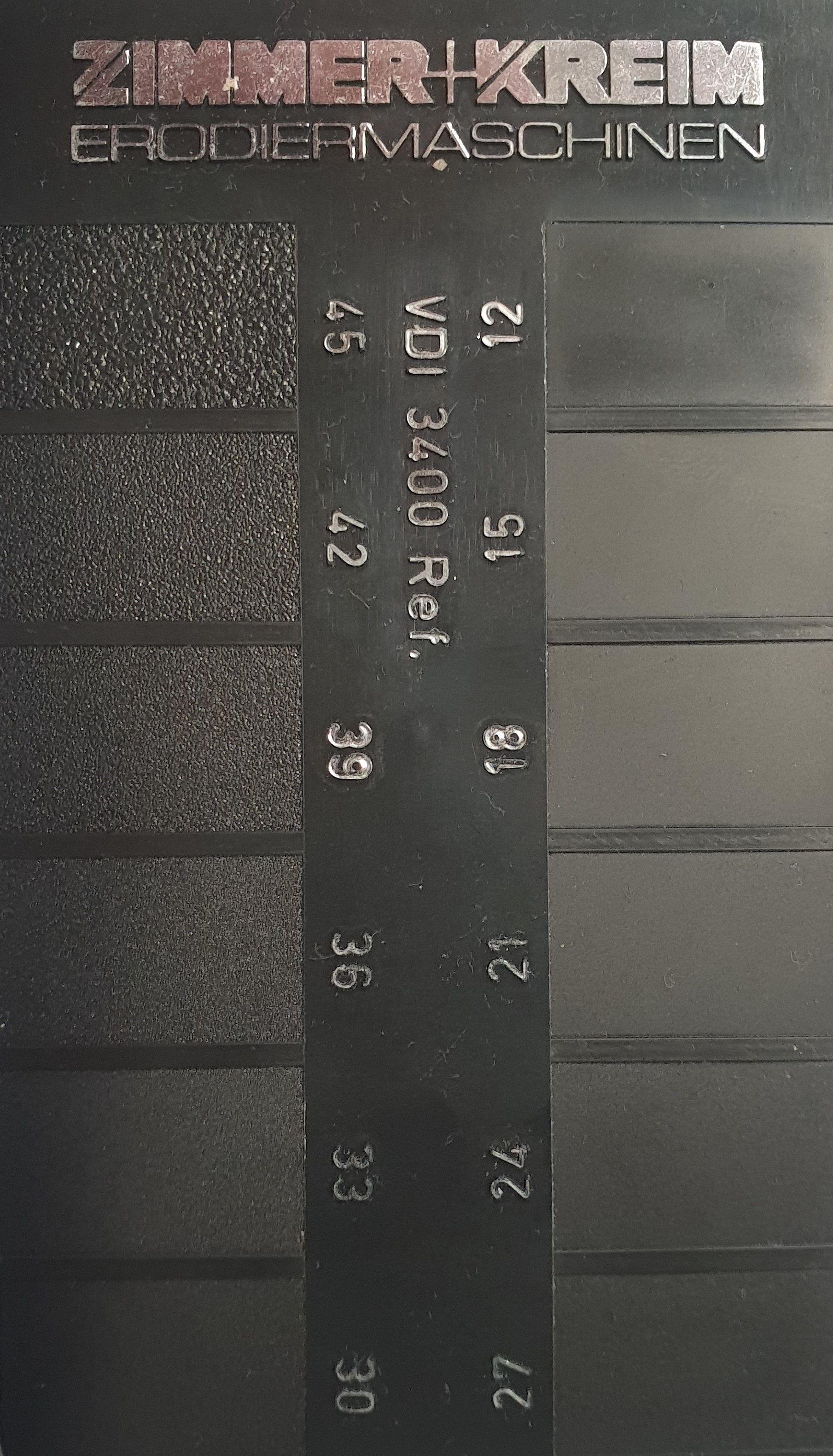

The VDI is a description of how to make a reproduceable grained structure.
It's a definition of a surface roughness.
For my test setup I'd like to have the DF23 volume combined with the VDI 36 surface.

Regarding the VDI grain: That seems to define a certain integral of the surface shape (I have not looked up all details), which can surely be computed for any surface. An accurate representation of your material will probably require more knowledge though, since multiple shapes coudl fulfill the same roughness criteria. How big the impact on your case would really be, again no idea...

CodeHD wrote: Fri Nov 27, 2020 12:57 pm since multiple shapes coudl fulfill the same roughness criteria.
You're right, this defintion is purely a mechanical one and different shapes do really create different light scattering... I know that this will require deeper investigation afterwards but at first a valid way to insert those data would be nice.

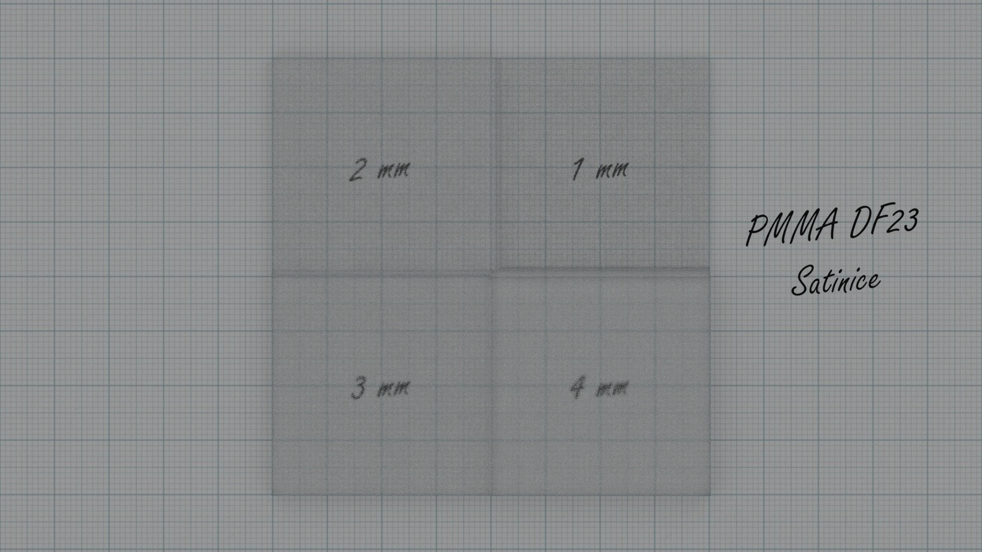

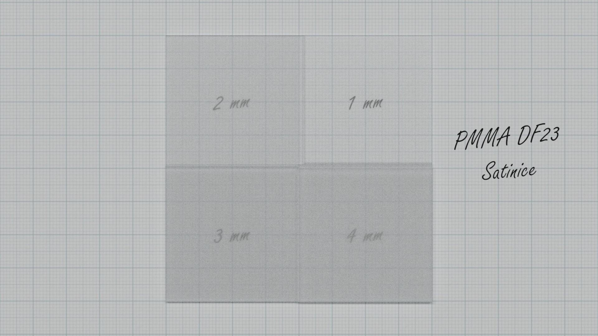

This is my current status:
Normal view:
still not blurry enough

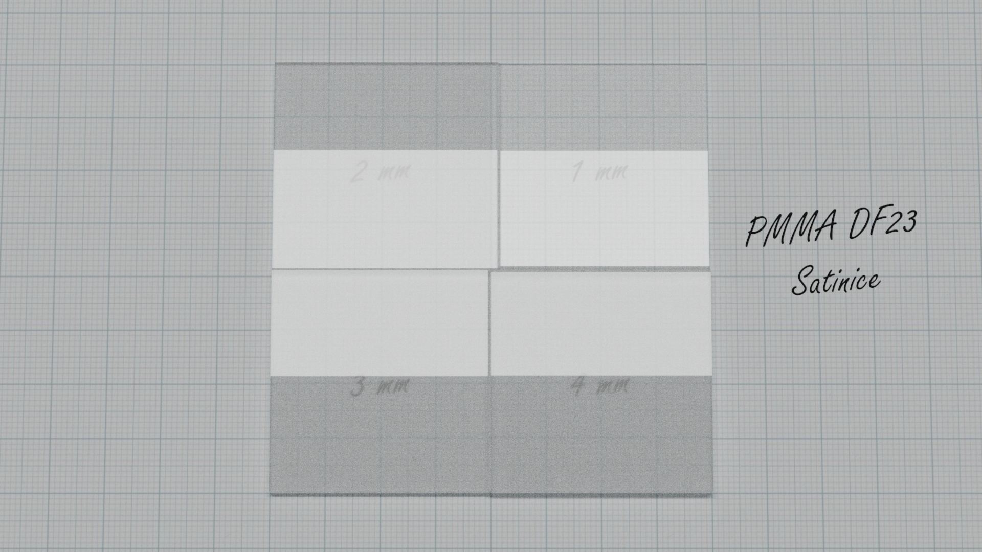

Slight tilted view for reflection:
good specular reflex

lighting_freak wrote: Mon Nov 30, 2020 2:06 pm I don't believe that we have to use anisotrophy settings. The material is a molding compound, no directional dependency is expected if you do some real parts from it.
If you want to model the ~20 degrees diffusion angles, then you do. With anisotropy = 0, scattering is equal in all directions and you have no HWHM by definition.
lighting_freak wrote: Mon Nov 30, 2020 2:06 pm I forgot to mention that the scattering cone that is mentioned in the pictures above is measured at a 3mm thickness. I could get it for other thicknesses as well.
One thickness should be enough.

Your full material is a combination of a volumetric scattering and a rough or "satinated" surface.
As said before, I would start with finding good values for the scattering scale and anisotropy. Note that for a good comparison with a real material, you should minimize other differences. Most importantly, compare it with a sample that has a polished surface, not rough.
Finding the right surface model may be a bit more tricky. For on-axis, the trick with anormal map might give you good results, but I fear at large angles you may see the influence from micorfacet-multiscattering. I'm not sure if any LuxCore matieral at the moment supports that.
