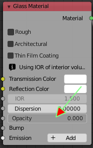

But Setting opacity of the glass to 0 and render with few samples to get the passes:
Denoising the first noisy render with these other passes we get a much better image:
So, what I suggest is to have the option to disable the glass from the normal and albedo passes, on the material.
