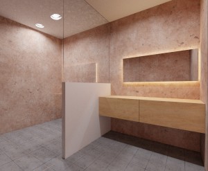

Hi all,
I'm having some trouble with glass reflections, after more than 7000 samples, I'm getting few samples on a glass reflection, compared with the rest of the space. What also makes the denoiser fails in that area. (Glass of the left side of the attached image).
Have tried with metropolis and sobol, and I'm rendering on cpu.
Any hint what could be the solution?
Thanks.

Nota solution to the noise, but have you tried using OIDN via the compositor instead? I can't find it at the moment, but I remember a video that denoised the passes individually and combined them, and it did work better for something I rendered.
Re: Trouble with glass reflections
Are all light sources outside the box enclosed by the glass ?

Thanks for the response,
Dade:
yes, all lights are outside the glass.
Zeealpal:
I will try, but still there is much less sampling in the glass reflection.
Regards.

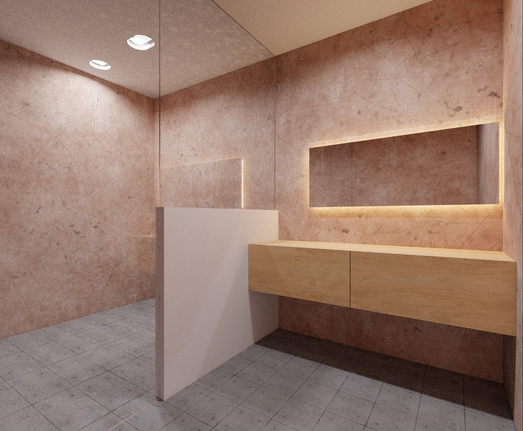

Your scene is a nice challenge. Rendered on CPU high resolution with some reflective and specular surface plus small artificial light in an enclosed space.
This is my result on a old i7 4930k. without denoiser in 5mn :
Raw
Denoised Edit 15mn
Settings
Clamping = 20
Light tracing = on
PGI = brute force radius scale (1) Photon count (2)
Caustic cahe = Default
DLSC = default
Meshlight with simple plane (no circle) importance set to 20.
Glass shadow color = 75% white

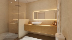

Try to remove the lights from inside the shower and change the outer ones with ies lights, not mesh. Maybe this is the problem.
Edit, when using PhotonGicache, the difference is much more noticeable.

hmm, raising the importance of the ceiling lights seems to have solved a lot the situation. Still making tests.
