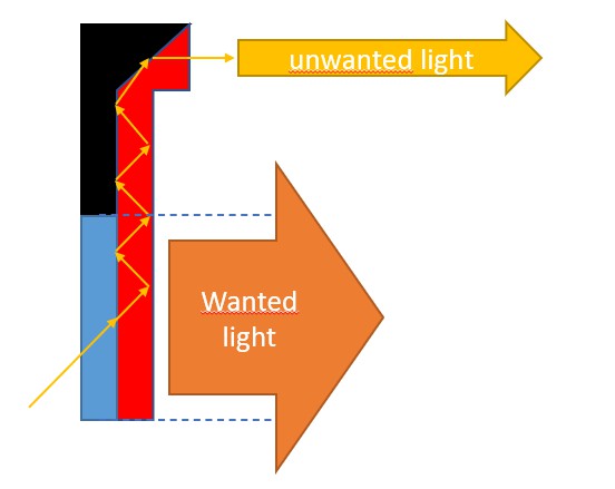

My work is all about car tail lamps. Their outer lens is often made from a multi-shot-mold. This means there are red acrylics meeting yellow acrylics meeting clear acrylics and from time to time also some black acrylics.
I wonder whether I could use luxcorerender to detect stray light and light leakage on those outer lenses.
That's the reason for trying to understand how this interaction works.

In your earlier post you write about light leakage. This sparks a separate question c), how thick is the black layer and will it even fully absorb incident light?
For car tail lamps, it sounds very detailed to me, and I wonder if the black acrylic in the situation you describe would produce any noticable stray light.

Question b: There should be no recognizable transmission of the black material. So no SSS is expected for this type of analysis. In fact you might be right in pointing out that some SSS may occur on very thin material slices.
Question c: This type of light leakage doesn't take into account any type of transmission through the black. It's assumed to be 100% opaque, but see b).
This is more or less the situation I am looking for.
