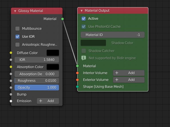

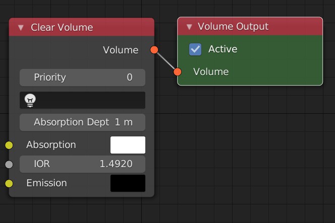

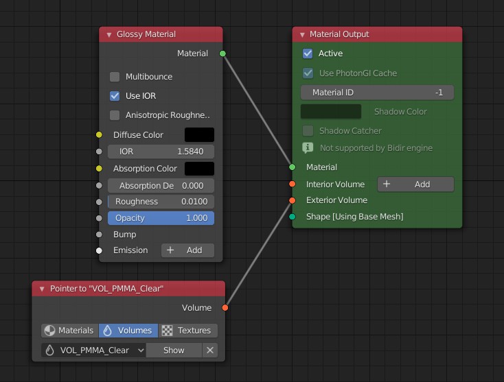

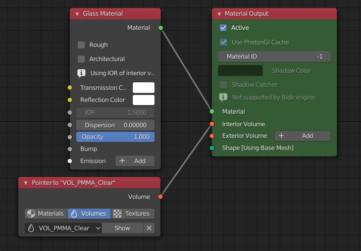

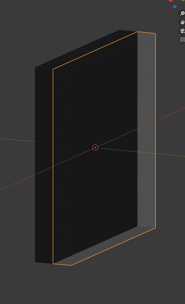

This is a simple setup.
A block that is made from two materials - one is a black one and the other one is clear. Both are with almost perfect polished surface qualities.
this is the material for all faces black to air:
this is the material for all faces clear to air:
this is the material for the face that both materials share:
Does the luxcorerender algo takes into account the little remaining difference in IOR of black and clear component?
