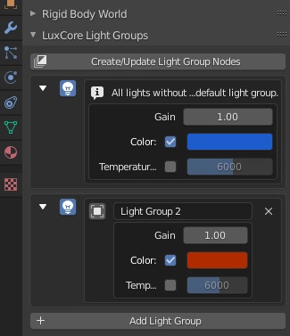

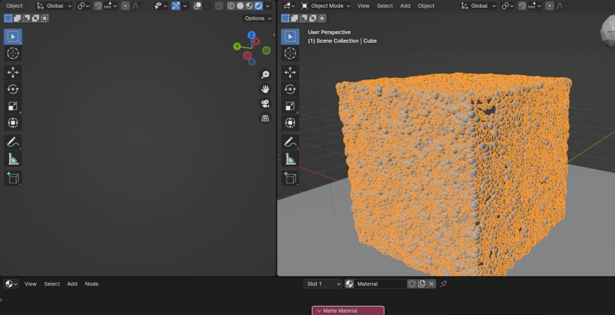

3,4,5,6 - I fixed alreadySharlybg wrote: Tue Nov 28, 2023 7:25 pm Hi , here are some quick bugs hunt result I found in recent

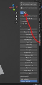

1__ Luxcorerender Online Library thumbnails bar is no longer visible (look like it is there and clicking in
the void select object but thumbnails are invisible.)

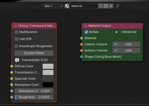

3__ glossy Transluscent and volume pointer dn't have output

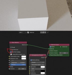

4__ thin film option in glass node turn material into matte

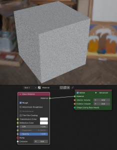

5__ Rough option in glass node turn material into matte / roughness option not visible

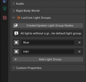

6__ Light groups options are gone

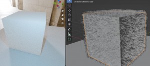

7__ Hair particles are no longer visible
8__ instanced object stop render from happening on viewport

Congratulation for the progress made.3,4,5,6 - I fixed already
Thanks to you we are just few inch closer
