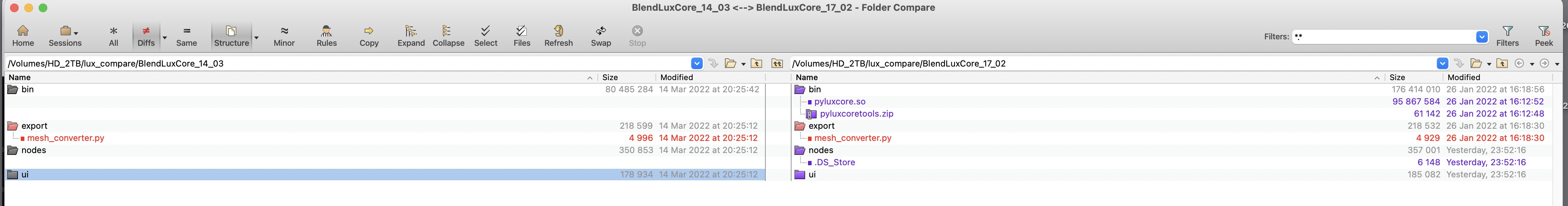

Don't mean to duplicate info that already posted in 3.1 thread in user support, just want to let know that for some reason Mac latest build seems to be broken.with a few more details:
I got a Beta fully working in 3.0 that I got in 17th February, I noticed the latest is broken for 3.0 and 3.1 Mac and so was the previous one (released abou a week ago?) didn't seem to work as well.Before that was ok with 3.0.
If its helpfull, debug file for Blender while attempting to enable LuxcoreBlender latest build:
https://www.pastefile.com/uekzgp
Also, in my home iMac I do have previous versions:
The one from 17th February works nicely with 3.0
This are the differences between them: the one from yesterday and the one from February: Bassicaly the file mesh_converter.py in export folder and the new one completely misses pyluxcore.so and pyluxcoretools in bin folder
