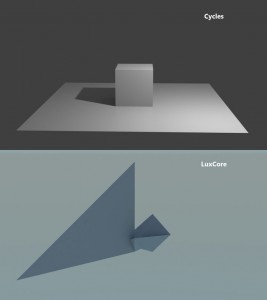

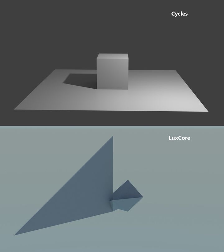

Right, so I compiled it running:
cmake-build-x64.bat /python310
and it builds OK, shows up in Blender 3.1, activates fine, but upon rendering, simple startup scene (cube on plane) is mangled... :?:
eg.
& report from console:

neo2068
Posts: 260
Re: Luxcore running on Blender 3.1
Post by neo2068 »
Ok. Then, something has changed in the blender mesh data structure or transformation. We have to have a look at it. Thanks for testing.
EDIT:
The mesh export is broken in Blender 3.1. I opened an issue:
https://github.com/LuxCoreRender/BlendL ... issues/756
Posts: 814
Thank you for looking into it and reporting.

JulianoLisboa
Posts: 146
Post by JulianoLisboa »
This problem still persists in today's new build, the cube is all deformed in rendering.
neo2068
Posts: 260
Post by neo2068 »
JulianoLisboa wrote: Mon Mar 14, 2022 11:17 am This problem still persists in today's new build, the cube is all deformed in rendering.
The first fix was only related to the compatibility with Python 3.10. I pushed a fix for the deformation problem. Now it should work with Blender 3.1.
