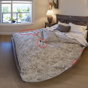

Hi there,
I've been having a problem with some places rendered as black. If I change the angle of the camera, they disappear.
I'm using Blender 2.93.5 with Luxcore 2.6 alpha0. If I render with Luxcore 2.5 on Blender 2.92, these spots are less noticeable and they look like dark stains. Link to simplified file:
https://www.dropbox.com/s/nma9s7b79ui2z ... blend?dl=0
It was made in Marvelous Designer. Does anyone know what causing this?

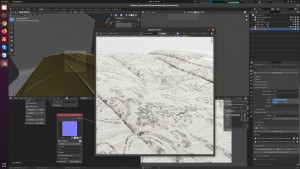

Re: Black artifacts
I'm running the test scene but it looks like it is working fine here:
Am I missing something ? What result do you get ?

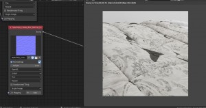

Taka
Posts: 65
Joined: Wed Mar 20, 2019 7:24 pm
Re: Black artifacts
Post by Taka »
Sorry, I decreased the Normalmap Height before saved the file.
If you increase the height, here is a result I get.
Re: Black artifacts
Taka wrote: Wed Nov 10, 2021 4:10 pm Sorry, I decreased the Normalmap Height before saved the file.
It is still working fine here even if I set the height to 20.0 but I think you have just forget to include the relevant normal map:
WARNING: Node "Imagemap.001" in tree "Duvet_FRONT_2": Could not find image "Seamless_crease_Blur_Normal_GL.jpg" at path "//../04_Shader/Fabric/Seamless_crease_Blur_Normal_GL.jpg" (Not an existing file: "/home/david/tmp/blackbed/../04_Shader/Fabric/Seamless_crease_Blur_Normal_GL.jpg")
You included "Seamless_crease_Blur.jpg" file but not "Seamless_crease_Blur_Normal_GL.jpg".
