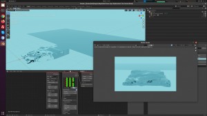

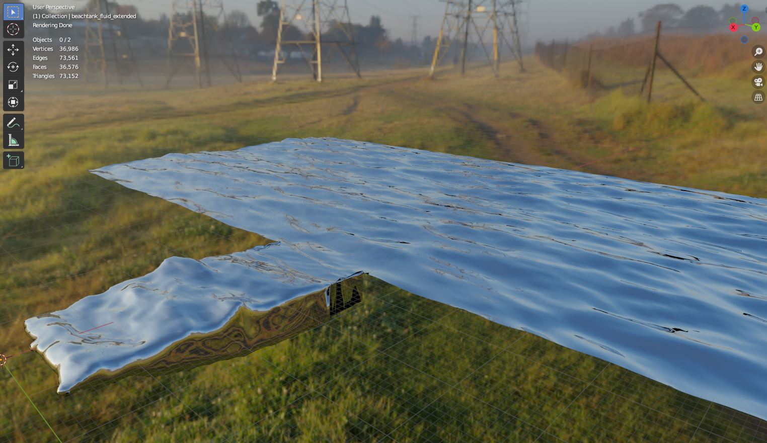

When I try to use an .exr vector displacement map in Luxcore with an imported alembic file, I get a semi-transparent mess with lots of strange artifacts, but it works perfectly fine with Cycles. What could the issue be? I've attached links to both the Cycles and Luxcore scenes, I couldn't attach them directly because they're too large. Thanks for your help!

From what I can see, your scene is working fine here:Rowquino wrote: Fri Oct 22, 2021 4:50 pm When I try to use an .exr vector displacement map in Luxcore with an imported alembic file, I get a semi-transparent mess with lots of strange artifacts, but it works perfectly fine with Cycles. What could the issue be? I've attached links to both the Cycles and Luxcore scenes, I couldn't attach them directly because they're too large. Thanks for your help!
What LuxCore version are you using ?

I'm using version 2.6. There aren't any artifacts in your scene but there's no vector displacement either, it's just completely flat. In the Cycles scene I screenshoted the vector displacement has been correctly applied to the rectangular portion of the geometry.

Re: Strange artifacts when trying to use .exr vector displacement map
You are setting the displacement map image gamma to 2.2: the reverse gamma correction (i.e. raw rendering is done linear color space without gamma correction) will destroy the values of the image pixels.Rowquino wrote: Tue Nov 02, 2021 8:54 am Okay so I've remade the file as just the one mesh and the displacement map, which I have packed into the blend file. I've also tested copying the blend file onto different parts of my computer and the displacement map is always recognised so the packing does seem to have worked. Here's the link:
https://drive.google.com/file/d/1qLuJJ7 ... sp=sharing
Check the image map flag "Normal map" to avoid any reverse gamma correction. You can than increase the displacement scale to see the map applied.
When I check 'Normal map', the Vector socket of the Vector Displacement node shows 'Wrong Input!' and however high I set the displacement, nothing shows in the render. The rendering is supposed to look like the image I posted at the top of the thread:Dade wrote: Tue Nov 02, 2021 9:25 amYou are setting the displacement map image gamma to 2.2: the reverse gamma correction (i.e. raw rendering is done linear color space without gamma correction) will destroy the values of the image pixels.Rowquino wrote: Tue Nov 02, 2021 8:54 am Okay so I've remade the file as just the one mesh and the displacement map, which I have packed into the blend file. I've also tested copying the blend file onto different parts of my computer and the displacement map is always recognised so the packing does seem to have worked. Here's the link:
